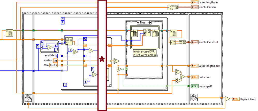

One thing that allows access in a parallel FOR loop to the same array are DVRs. Note that the IPE(DVR) structure protects from concurrent access, but since this is a very small critical section, it does not stall the various parallel instances much.
However, even the following modification only gives a marginal improvement (<5%) over my old code.  (The * box contains the code as before, not shown for simplicity)
(Note that you need to be sure that the sections don't overlap, else the result will be unpredictable because the order of replacement cannot be guaranteed)
