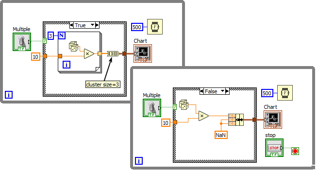

I am trying to program 2 conditions using a case structure and a switch. Switch has 2 values, i.e when switch is on it sets the multiple case and when switch is of it sets the single case. Now what are the multiple and single cases. I have a while loop around the whole program with a wait of 500ms. Now in the single case a random number generator generates values every 500 ms and when the case is in multiple 3 random number generates values every 500 ms. What I want to do is represent these conditions in a waveform chart. So when the switch is in the single position then the waveform chart will show the single random number generators value over time and similarly when the switch is in the multiple position the waveform chart must be able to show all 3 values varying over time. But when i dont know how to do this. I have attached the vi which I attempted called sample.vi. Kindly do help me. Thanking you in advance.

Hi govind,
both cases need to output the very same data type (think DATAFLOW!).
So your "single" case needs to hide those two additional plots by filling them with NaN values!

Accepted by govindsankar
Here is basically what Gerd was suggesting.
NaN values are not shown on charts and graphs. Make sure to correctly set the cluster size of array-to-cluster.
(You only need exactly one "10" diagram constant. You can use a FOR loop to repeat a certain operation (e.g. generate random number and multiply it). No need for all that duplicate code.)
