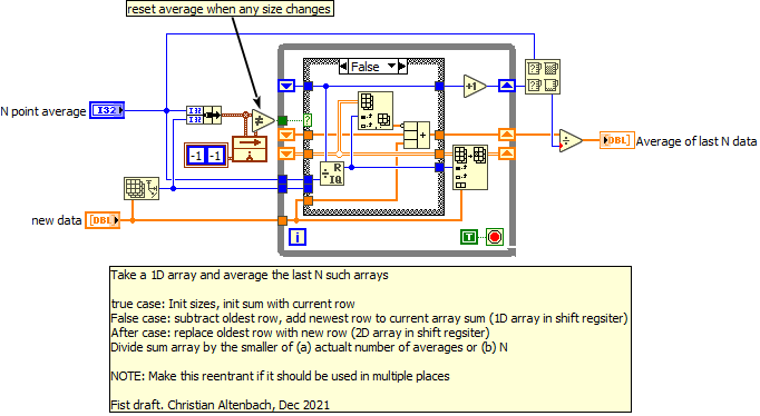

Here's a quick demo how you can average the last N values of a 1D array (works with any history length or array size)
Just a quick draft. Check for bugs!
Note that this is efficient because it also keeps the running sum where it subtracts the oldest and adds the newest data. Much less math that always averaging all columns. (See my old presentation for details)

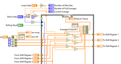

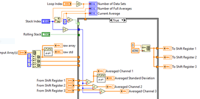

What you mention sounds ideal. I am not sure what the most elegant way of doing this would be, however, is this what you had in mind:
As for vi, I posted a stripped-back version. Had a second go at that, so hopefully, the attached a better representation. In this example: the red plot is the stacked average of the input arrays (blue plot). Currently, the red plot updates every "stack index" interval. What I am trying to do is update every time a new array is received for the same "stack index" size (one in, one out).

(4,822 Views)
You can take your 2D array and autoindex it on a FOR loop. Inside the FOR loop, place my VI. Take the output and autoindex at an output tunnel to get the "averaged" array of same size out. Each row will have the average of the 100 previous rows (except for the first 100 rows, where we have fewer, of course).
