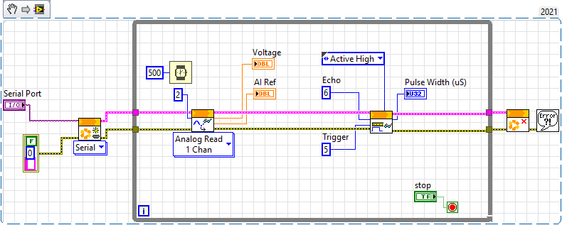

For all the reasons santo_13 mention above something like this is the best you can hope for...

That's working as hoped. Thanks very much.
