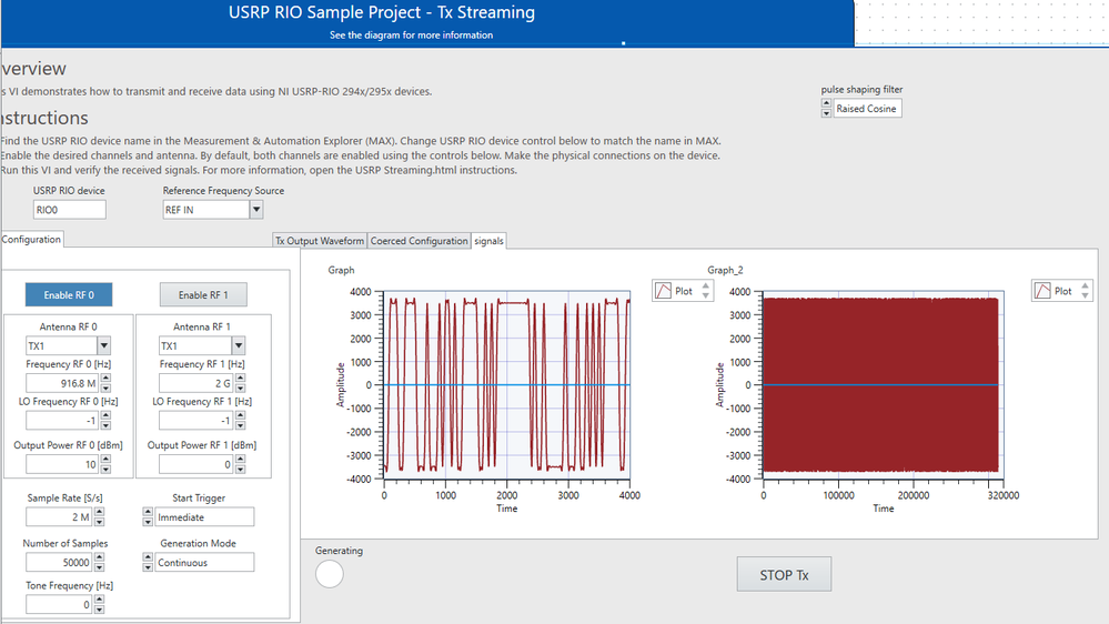

    I am currently running an experiment where I send a 916.8MHz BPSK signal from a USRP using LabVIEW NXG 5.0. This signal will be received by a pair of Software Defined Radios controlled by MATLAB.
    However, I’m not sure if all the BPSK signals sent from the USRP are received by the SDRs. So, I am trying to do a CRC test against the BPSK signals received, but I’m not sure how to do this.
    I tried using a LabVIEW NXG function called “MLS sequence waveform” where I supposedly could select the maximum number of digits for the binary message before it cycles back to the first digit, but I can’t figure out WHAT the actual binary message is. And because I can’t see what the binary message is, I can’t tell MATLAB what message they are supposed to find.
    If anyone can give me any advice, that will be appreciated!!
