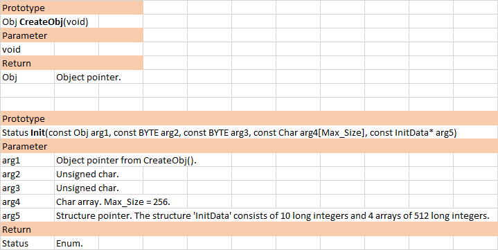

The two DLL functions I need to use with Call Library Function Nodes in a VI are described below. I used generic names here for readability.

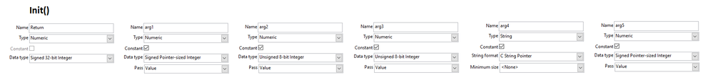

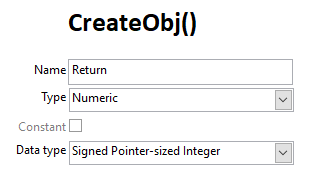

Node parameter settings I set for each function are shown below.
(1) Do you find any incorrect settings? I am quite new to this.
(2) How do you create a pointer to the structure for arg5? I created a cluster of 10x I32 elements and 4x arrays of 512x I32 elements. How do I create its pointer to feed into arg5? Do I need some wrapper to take the cluster by value and create a pointer?

1) It seems ok after a brief glance
2) You did not give enough information to say for sure. Show the actual declaration of the structure and function prototype! You seem to go to great lengths to try to obfuscate what hardware this is about. But while the C syntax often isn’t enough to describe an API fully, replacing the syntax through prosa text entirely isn’t very efficient either.
LabVIEW arrays never translate directly to C array pointers, but you can configure a Call Library parameter to let LabVIEW do the necessary conversions but not when they are inside clusters. It “seems” your arrays are in fact fixed size which makes them inlined in the structure and not a pointer, but I want to see the actual declaration before explaining more!

Thank you for your comment, rolfk. It would take some time to get the header file from the original author of the DLL. What would be the recommended solution if we assume the arrays are inlined in the structure?

That would be simply a single array of 10 + 4 * 512 Int32 elements, passed as a C array pointer. Insert the data at the correct offsets:
0 - 9: for the first 10 elements
10+: for the first array
522+: for the second array
1034+: for the third array
1546+: for the forth array
Make sure the array is really 2058 elements large just to make sure!

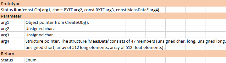

Here is another function 'Run' in the same DLL. The structure here includes multiple types of members.
That tells me we cannot treat the structures in this DLL as arrays. What would be the 'standard' way to pass these structure pointers to Call Library Function Nodes?

Well you still could maybe represent them as an array but would have to treat the parts differentely. However there is something very fishy about that documentation.
MeasData consists of 47 members
unsigned char
long
unsigned long
unsigned short
array of 512 longs
array of 512 floats
That's according to my counting only 6 members (or 1028 if you count array elements separately!!
unsigned char
long
unsigned long
unsigned short
array of 512 longs
array of 512 floats
That is a list of data types used in the structure. There are multiple unsigned char members and so on.
In the meantime, I could check how InitData structure is defined. It was as expected. MAX_CAN_COUNT_SIZE is 512.
