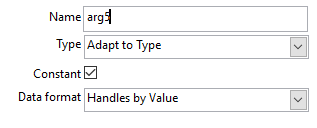

Node parameter settings I set for each function are shown below.
(1) Do you find any incorrect settings? I am quite new to this.
(2) How do you create a pointer to the structure for arg5? I created a cluster of 10x I32 elements and 4x arrays of 512x I32 elements. How do I create its pointer to feed into arg5? Do I need some wrapper to take the cluster by value and create a pointer?

1) It seems ok after a brief glance
2) You did not give enough information to say for sure. Show the actual declaration of the structure and function prototype! You seem to go to great lengths to try to obfuscate what hardware this is about. But while the C syntax often isn’t enough to describe an API fully, replacing the syntax through prosa text entirely isn’t very efficient either.
LabVIEW arrays never translate directly to C array pointers, but you can configure a Call Library parameter to let LabVIEW do the necessary conversions but not when they are inside clusters. It “seems” your arrays are in fact fixed size which makes them inlined in the structure and not a pointer, but I want to see the actual declaration before explaining more!

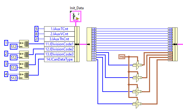

Accepted by Arcanix
@rolfk wrote:
Well you still could maybe represent them as an array but would have to treat the parts differentely. However there is something very fishy about that documentation.
MeasData consists of 47 members
unsigned char
long
unsigned long
unsigned short
array of 512 longs
array of 512 floats
That's according to my counting only 6 members (or 1028 if you count array elements separately!!
That is a list of data types used in the structure. There are multiple unsigned char members and so on.
In the meantime, I could check how InitData structure is defined. It was as expected. MAX_CAN_COUNT_SIZE is 512.
struct InitData {
   long lAuxTCnt;
   long lAuxVCnt;
   long lAuxThCnt;
   long lAuxHCnt;
   long lAuxGasCnt;
   long Reserved1;
   long Reserved2;
   long Reserved3;
   long lCanMasterCnt;
   long lCanSlaveCnt;
   long lDivisionCode1[MAX_CAN_COUNT_SIZE];
   long lDivisionCode2[MAX_CAN_COUNT_SIZE];
   long lDivisionCode3[MAX_CAN_COUNT_SIZE];
   long lCanDataType[MAX_CAN_COUNT_SIZE];
I was able to make the DLL function work. Since 'Array To Cluster' can create a cluster of only up to 256 elements, I used 'Type Cast' to convert each array into a cluster of size 512. For typecasting type input, I still used 'Array To Cluster' to create a cluster of 256 elements and copy-and-pasted them to create a cluster of 512 elements quickly.
Thank you, folks!
