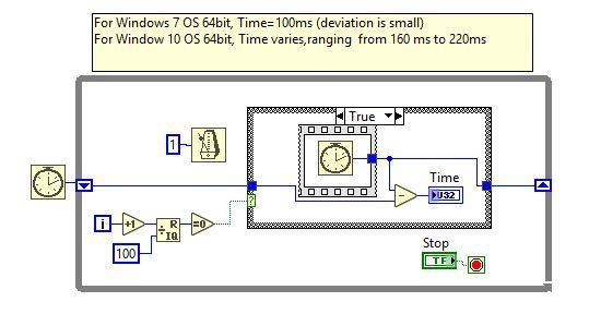

Same VI in Window 7 and Window 10
Why ?
For Windows 7 OS 64bit, Time=100ms (deviation is small).
For Window 10 OS 64bit, Time varies, ranging  from 160 ms to 220ms.
Message 1 of 11
(2,673 Views)

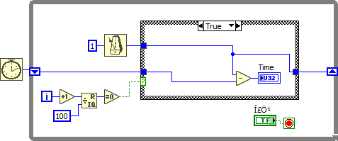

Windows is not a realtime OS and your experiment hints that the OS is to blame, not LabVIEW.
(See also)
Of course your message is a bit sparse because we don't know what else has changed. (computer hardware, CPU, LabVIEW version, etc. etc.). Unless all you did was change windows version while keeping everything else constant, all bets are off anyway.
(Also, can you explain why you need that sequence structure? In fact, the wait function outputs the ms value, so the following code would be equivalent:)
Personally, I would use "high resolution relative seconds" for the ticker. Still does not change the fact that windows cannot guarantee milliseconds.)

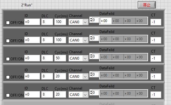

Same PC hardware ,same LabVIEW version and different Windows OS.
The original design aims to simulate CAN node to transmit CAN messages cyclically with different periods. Setting waiting-time equal to 1ms is used as time quantum.When the elapse time is integer times of period of certain message, the message needs to be transmit. The period ,purely up to the user's definition, is changeable.
