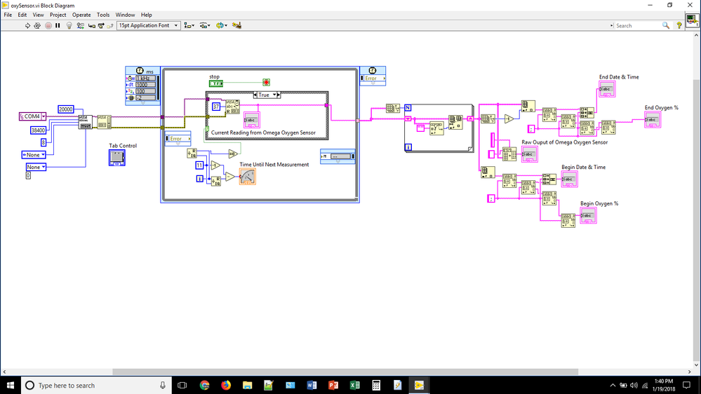

Hello all,
I am currently writing a basic program to read in results from an oxygen sensor that communicates via serial connection. In my current code, I keep getting an overrun error after a few times of running the program. Any suggestions as to how I can fix it? Thank you!serialError.png

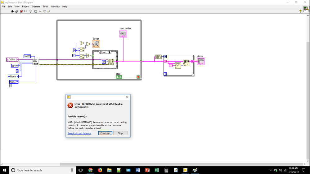

The device sends an update every 10 seconds, I used a timed loop with a case structure so that it calls the Read vi every 11 loops (11 seconds, 1 extra second just to be safe), also, I have the timed loop set to 1 second so that it updates the counter gauge every seconds indicating how much longer until the next measurement.

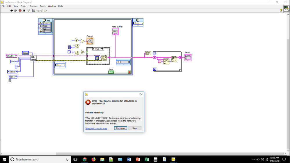

Also, replacing the timed loop with a while loop does nothing to help:

Just needed a Flush Buffer at the beginning, everything works fine now, thanks for the quick repliesfixed.png

I think the real problem is that you never close the serial port.
If the serial port was closed, you wouldn't need a flush buffer because you are starting to read from it right after you configure and open it.
HOWEVER, you never close the port in your VI.  So if you stop the VI and restart it, the port will have remained open and the buffer accumulating bytes until it overflowed which you'll find out once you restart the VI.
You can leave the flush buffer in, but be sure to wire a VISA Close in before the VI ends.
