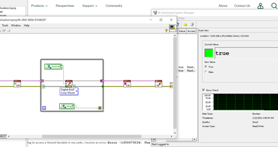

I have created two shared variables and distributed and deployed them to the distributed systems manager. The VI I am using is interfacing with my cRIO through DAQmx API. I am wondering why whenever I switch the variables to be true, they both still indicate false? Is there something I am missing whenever I am deploying these shared variables?

error-1950679034, I've checked the IP Addresses and they are the same.

nevermind problem was solved, duplicate shared variable folder.
