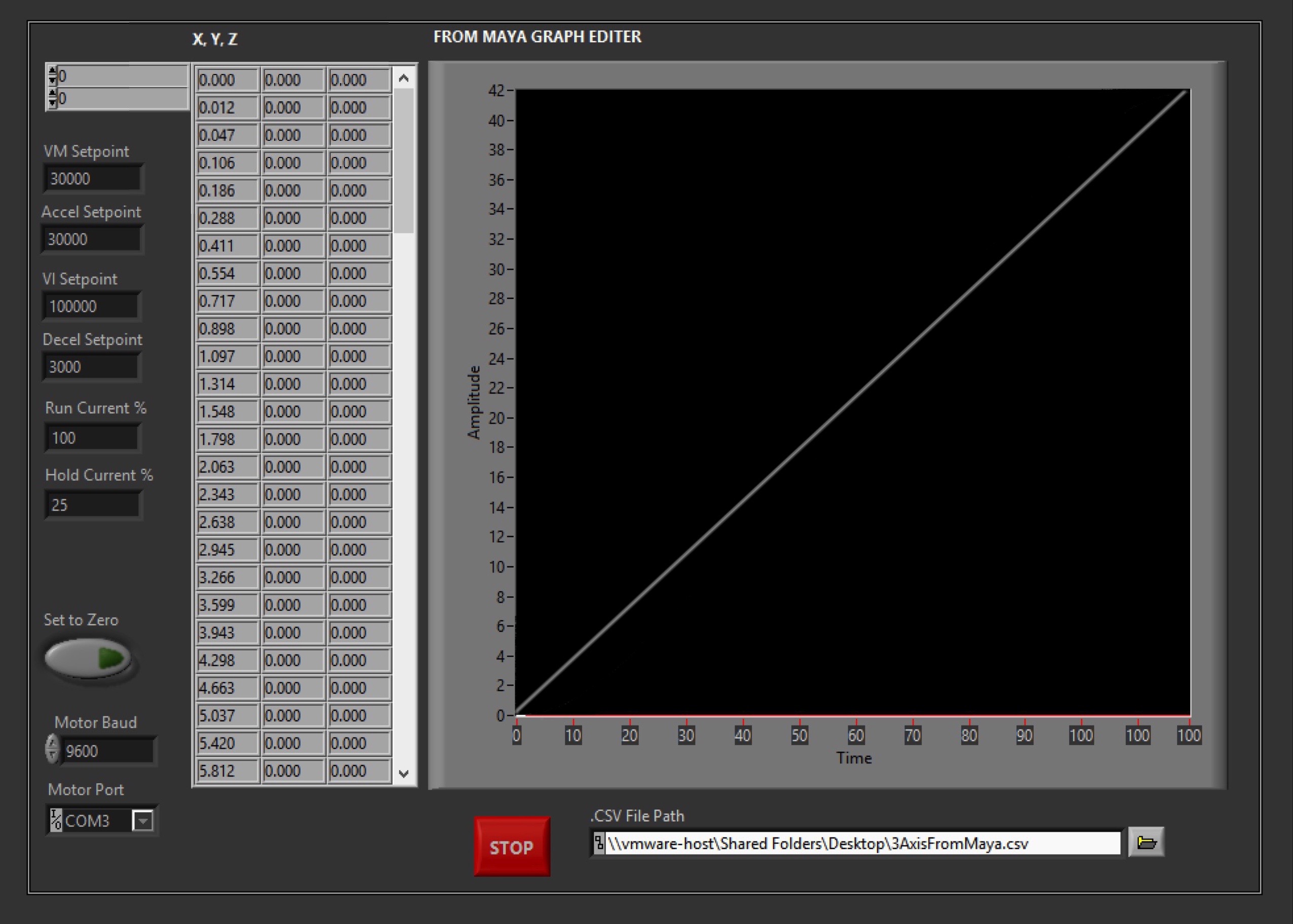

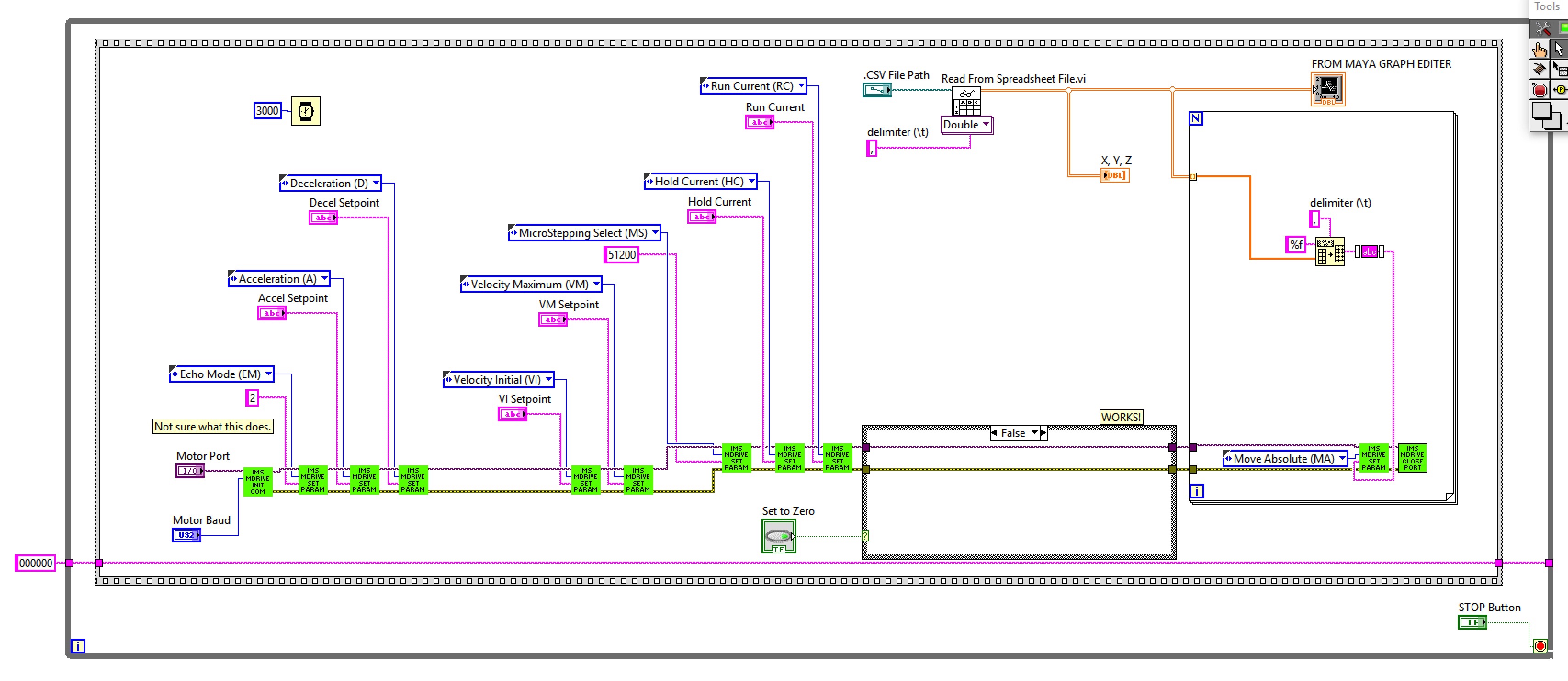

I have tried the VI `attached with two curves:
1) A curved spline from Maya via Excel a: .CSV
2) A linear spline from Maya via Excel as a: .CSV
Here are the curves:
The Linear curve works perfectly. But the curved spline jitters.

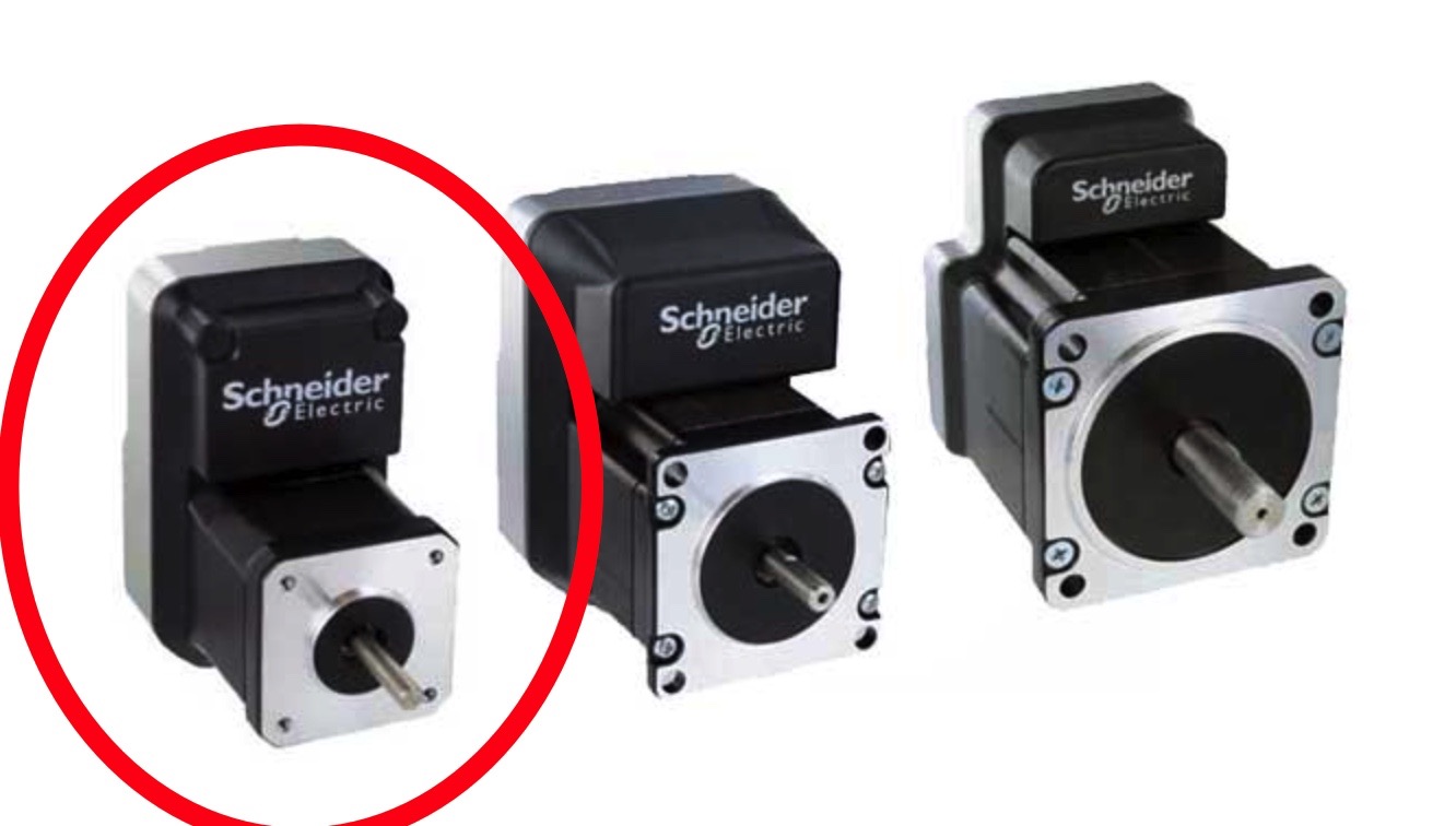

The motor is a Schneider Lexium MDrive Nema 23.

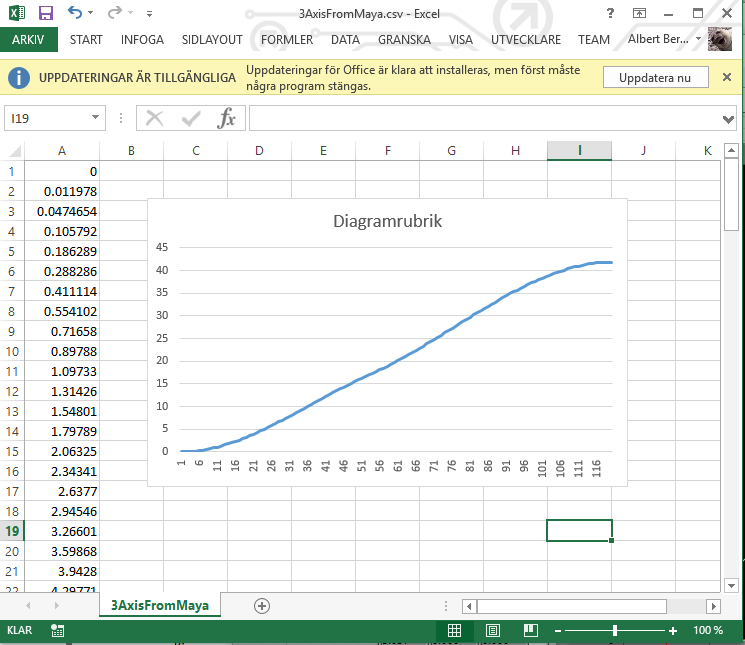

It seems the export from Maya is to blame, you get the exact same result if drawn in Excel. Of course this graph assumes a fixed distance between each Y-value, if it's somehow optimized by dynamic X-size you'll need that exported also.

Your first graph displays the acceleration and deceleration characteristics along with the constant velocity state.  In your final FOR loop, how are you controlling update time for stepping?  Are the steps for a rotation being handled by another piece of equipment?  The number of steps needs to occur at constant intervals.  It will look choppy if the number of steps is varying along with the update rate that they are sent to the stepper.
BTW: your charts are set for only 1 significant digit in the time axis.

This is a stab in the dark but I'm guessing you don't want to close the COM port in every iteration of the loop.  Move that VI outside the FOR loop.

Thank you for the reply. I will look more at the Maya export. I will try to find out what that is. Another member mentioned the update of time in the FOR loop. That is missing. I will look into that too.
