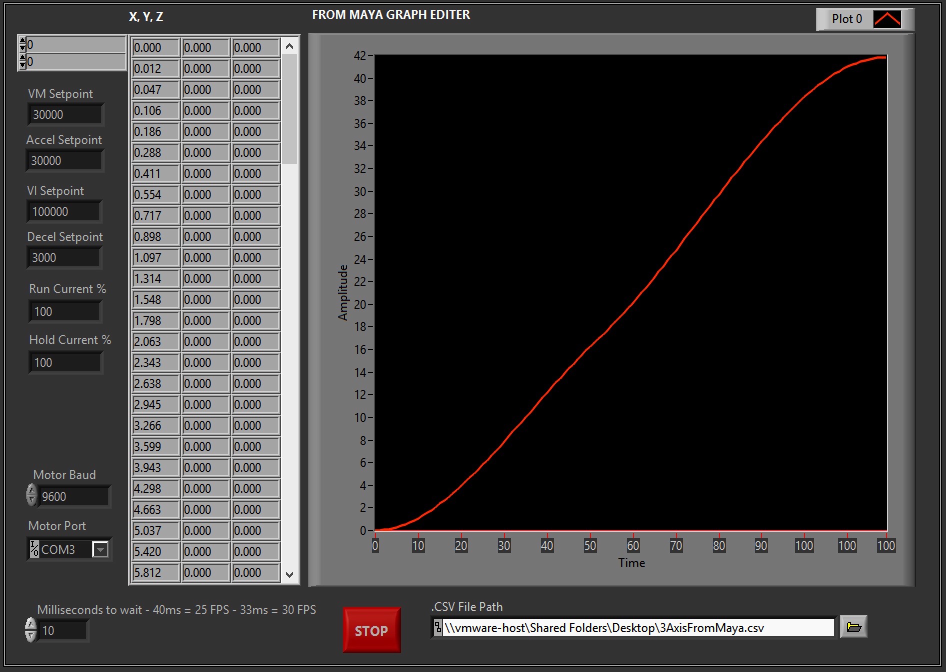

3) Move Absolute (MA) was not the best way. You can't throw a bunch of numbers at this thing. You get jerky movements. Prove that to be correct.
4) The best way is to use Slew (SL) and create a match to curve Function.

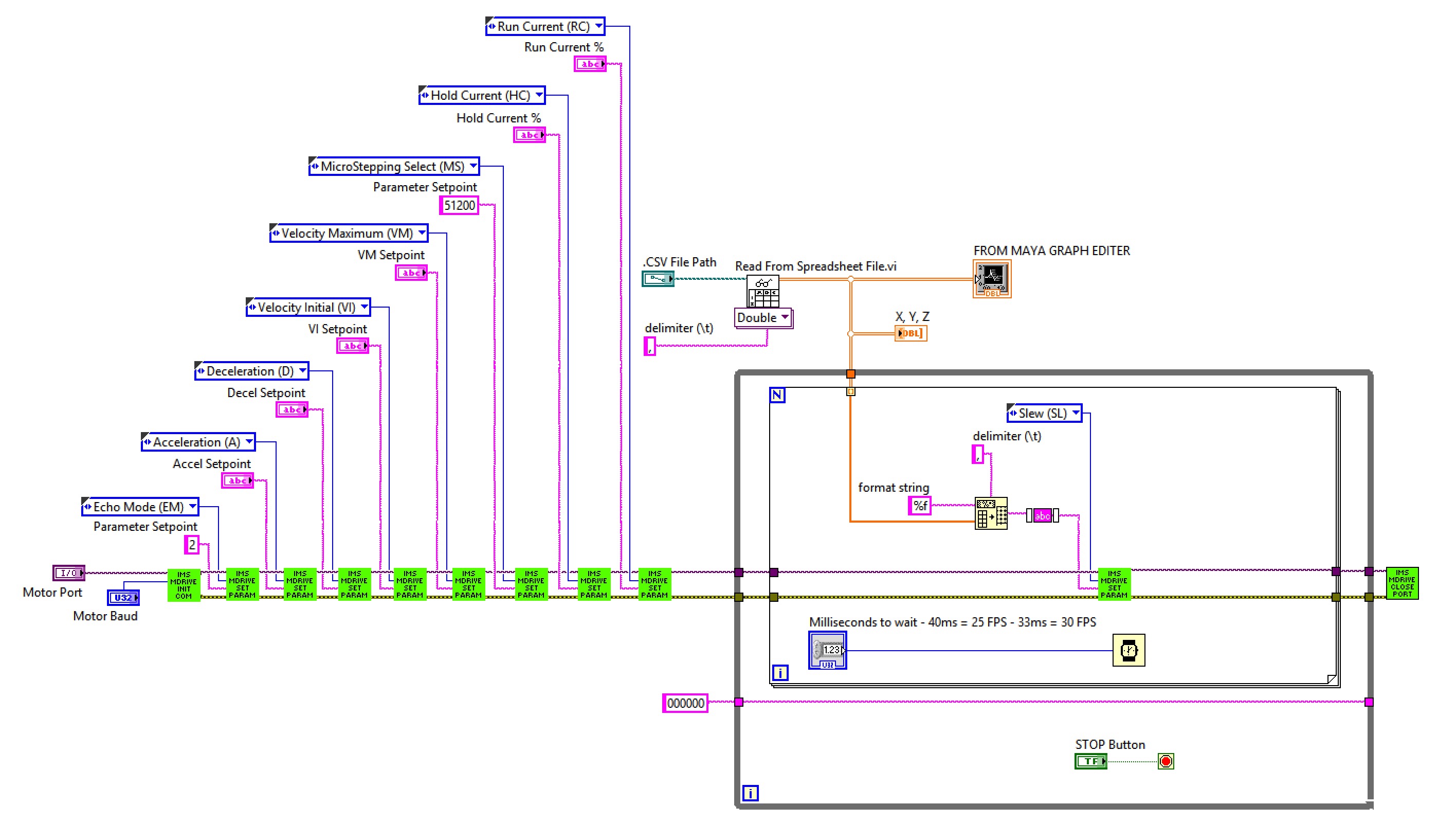

I tried it and used what I learned to make this:
This test works very smoothly.
This is what the motor engineer has suggested, but again it is not as easy as I would wish. That said I started to make it work with my limited knowledge of the world, life, and LabVIEW.

So now you would write a loop that looks like this:
·         Read current position (send PR P) to the motor, wait for reply
·         Call function F
·         Send the new speed command to the motor (SL).
·         Wait until the next frame starts
·         Loop
I have started to make this, again with no idea how to do it. But it just keeps working.

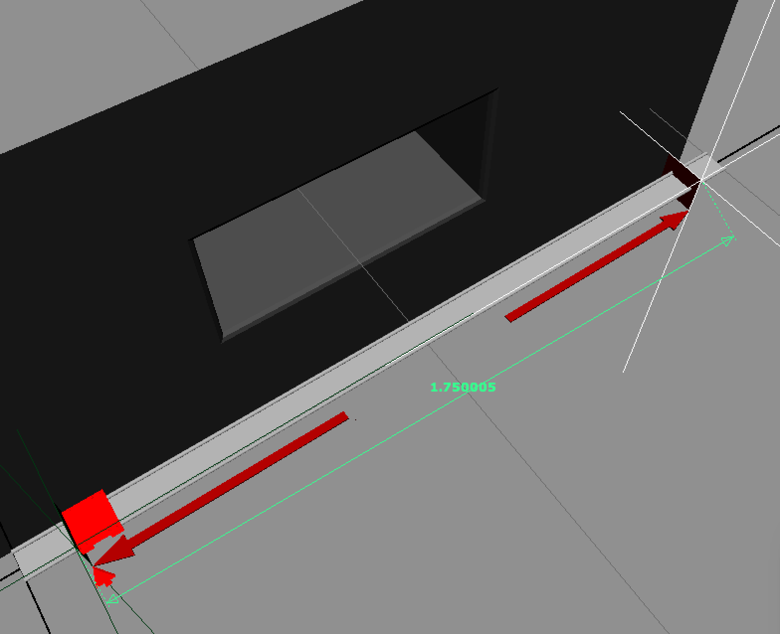

This is a diagram of the slider could help work out the information needed above.
My Math knowledge is worse than my LabVIEW attempts so this is going to be fun.

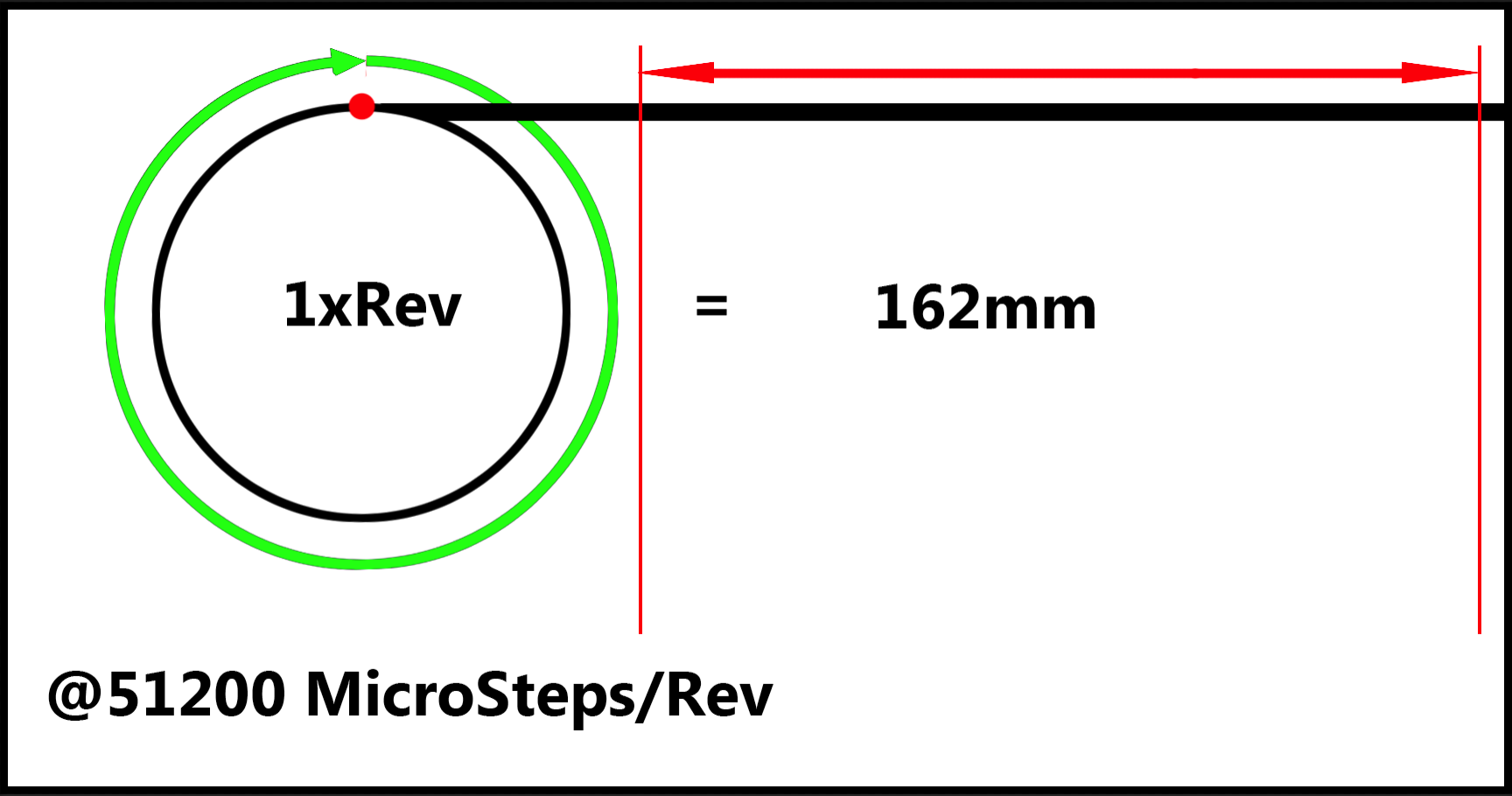

BTW:
This was the math we used to adjust for the pulley and distance moved in the following diagram:
output*1280/9
