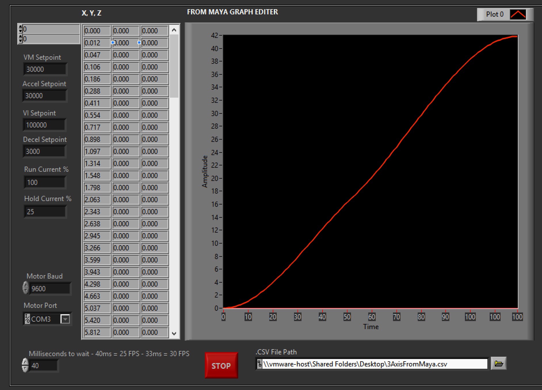

Smoothing the output .CSV file to Stepper Motor
Is this correct?

This is where I am.

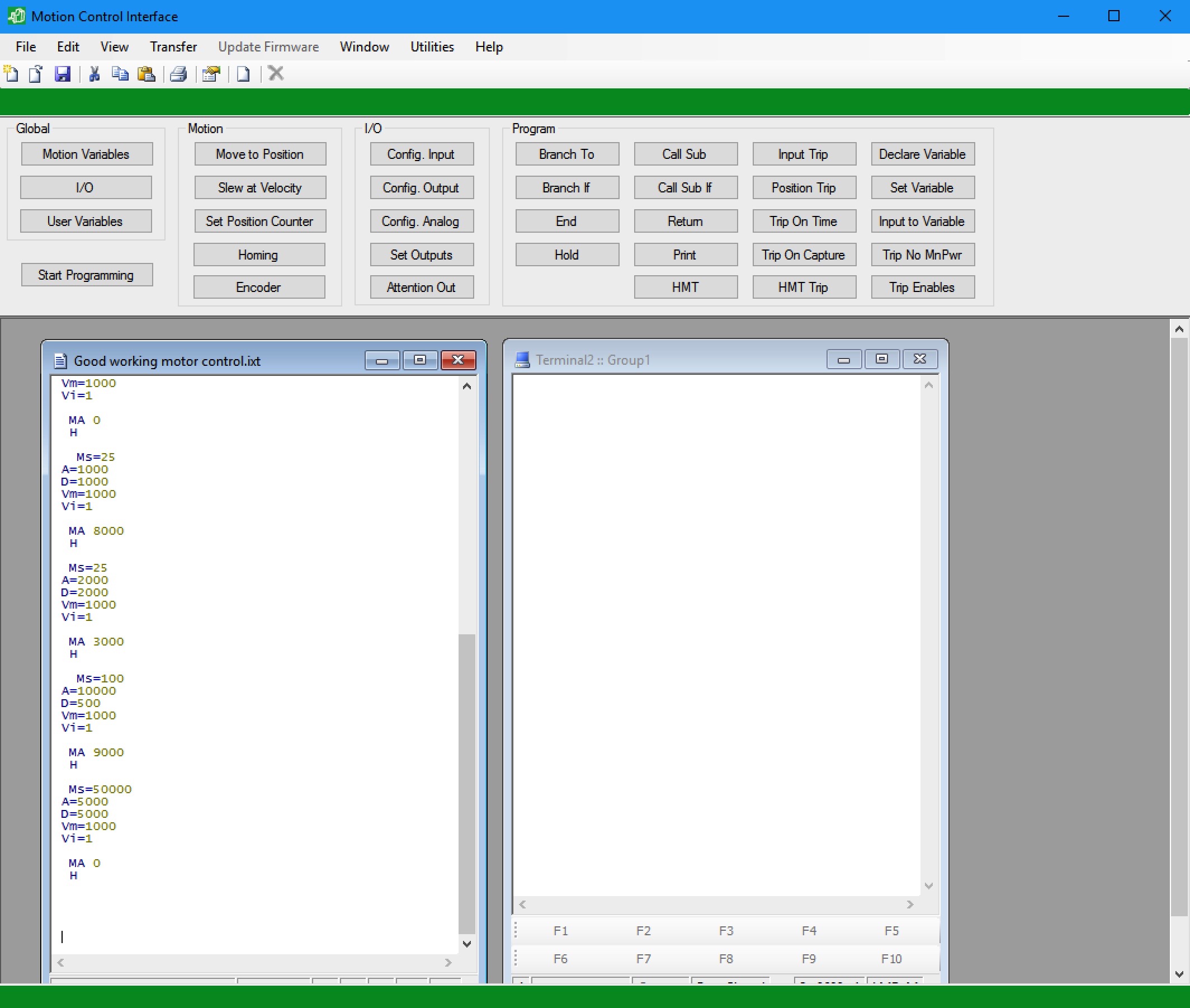

Here is more info that might help to solve this problem.
Normally this type of motor is controlled with its own MCode Terminal.
Schneider have their own software (that said, they also created the .VI's):
The Terminal ooks like this:
The commands there made the motor move very smoothly in several curves. Blue is forward and Red backward. The Motor ramps up and down very smoothly.
I think the commands in the code are the same as the commands in the .VI below.
The VI. was made by
I feel that something is mising from the current .VI that is shown in the MCode.
Hope someone outthere undersands this stuff ;o).

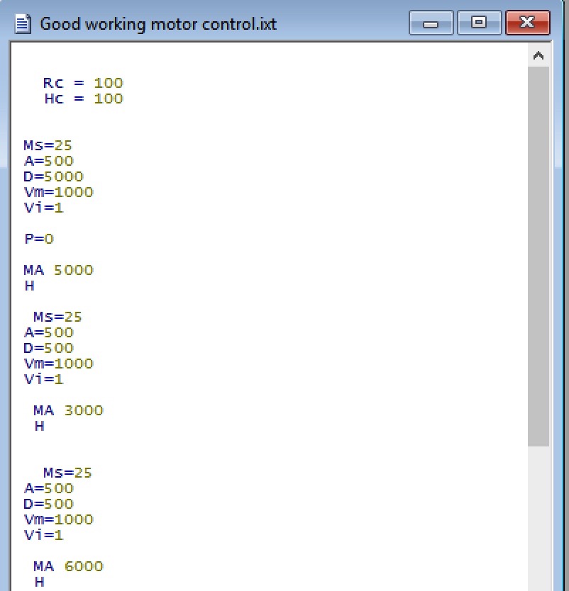

One observation is the "H"
This is my thoughts on the problem.
That H (HOLDS) the second input/number while the motor finishes the first. Without that, the second number (and the following) jump in and send the motor to the new number.
I feel, and it looks like this is happening. As all the numbers load, the motor moves to them, "BIG BUT" But I think the numbers pour in faster than the motor moves, thus creating the fragmented moves. The last (Go to Zero) works because nothing else gets loaded.

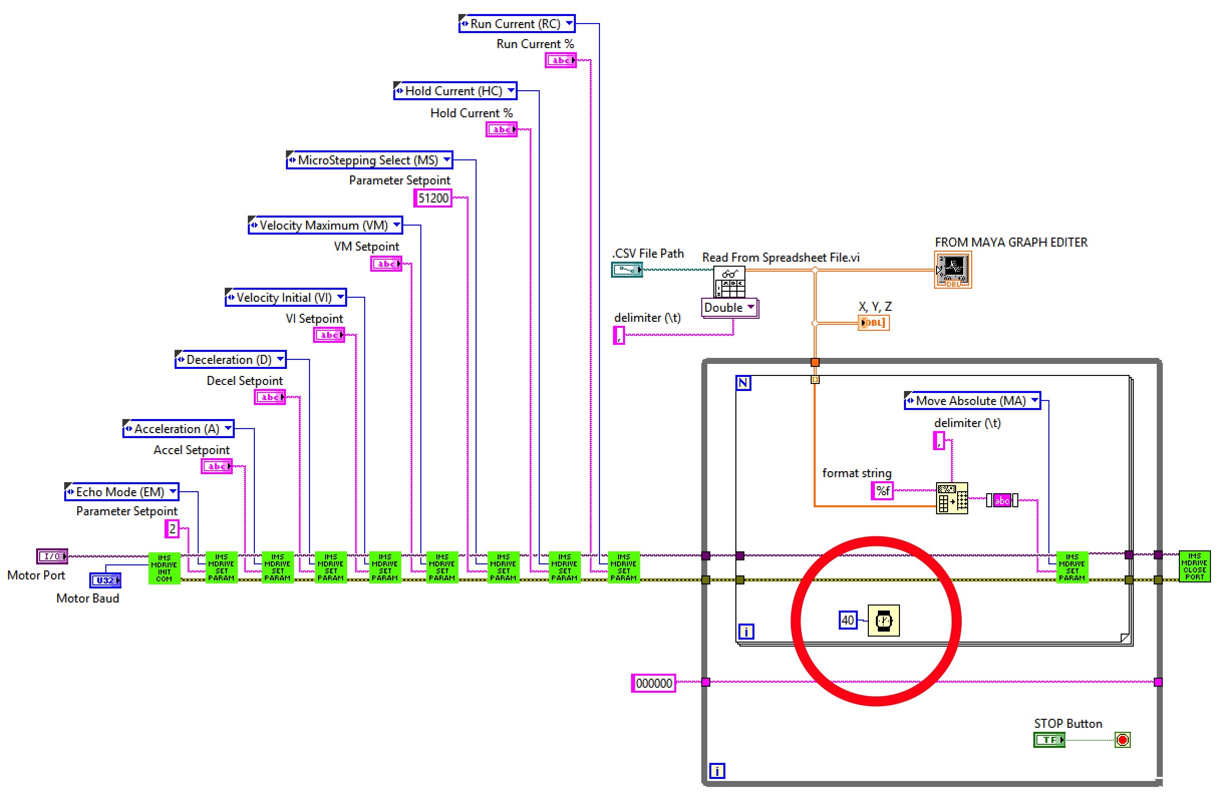

I'm trying to get this to work in LabView:

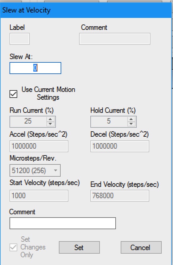

It has been recommended that I look into the Slew command of the motor. I did experiments and got very smooth results. I am currently working on a VI that allows the motor to match the Slew to the .CSV file.
If anyone has ever done this please help.

A brief scan of the motor doc suggests that only trapezoidal velocity profiles are supported.  You won't be able to fully match the arbitrary trajectories generated in your modeling software.
It seems kinda unlikely that you'll be able to track a desired trajectory very closely using "immediate mode" to communicate with the controller, whether you're doing positional moves or slewing at a fixed speed.  Just warning you so you can set your expectations realistically.
There's a programmed motion mode available that may help some, but you'll still be stuck with trapezoidal motion segments.
-Kevin P
Message 29 of 33
(1,778 Views)
You could try doubling the wait time inside your FOR loop as it may be an update/lag issue between the vi-->Controller-->Stepper.  See what your results look like.  If they are worse, you might even have to speed things up.  Perform a few experiments - Design of Experiments (DOE) to determine.  Your communication Baud rate is set at 9600.
