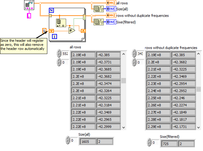

Here's how you would keep only the first encounter of each frequency value.
(it also removes the header row. For simplicity we assume that zero is not a valid frequency, else some simple changes would need to be made. We also assume that duplicate frequencies are in adjacent rows.)

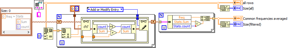

Here's how you could average all values from the second column for each unique frequency (using maps this time).
(Note that this is more rigorous, because duplicate frequencies don't even need to be adjacent. The output will automatically be sorted by frequency.)

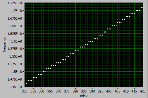

Could it be that your frequencies are originally not really duplicates, but that the first column was accidentally saved with insufficient digits? Maybe you could restore the full frequency range by linear fitting, for example. except for the first point, the frequencies are very linear!
