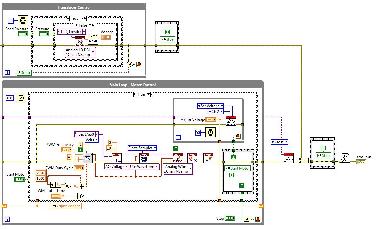

As I have not got this figured out yet, I am posting the guilty code in hopes someone might shed some light on what is causing the issue.  Code is pretty generic in nature with only one sub vi (also attached) and a couple simple tasks for reading the analog-in.
This is on LV 2013 on a win-7 32 bit system using a PCI-6014 daq.  Analog read tasks are both on AI8. One task is configured to read the straight voltage from the transducer (0-10vdc) and the other uses a custom scale to convert to pressure.  Either one causes the conflict.
Pressing the button to start the motor run works as intended by itself.  Default values for waveform are correct for my application though total pulse time (4 seconds) can be adjusted without consequence. (Note, waveform output controls an isolated SSR that contrls the higher level voltage)
Running either option on the read pressure routine causes the analog out for the motor to wig out.  Stops pulsing and goes to a straight high condition.  If it is on first, starting the motor causes just a little blip of output for 4 - 5 clicks then eventually just sets the AO to high as well.  Continued clicking of the start eventually returns it to blip mode but not to the regular waveform that it is configured for.

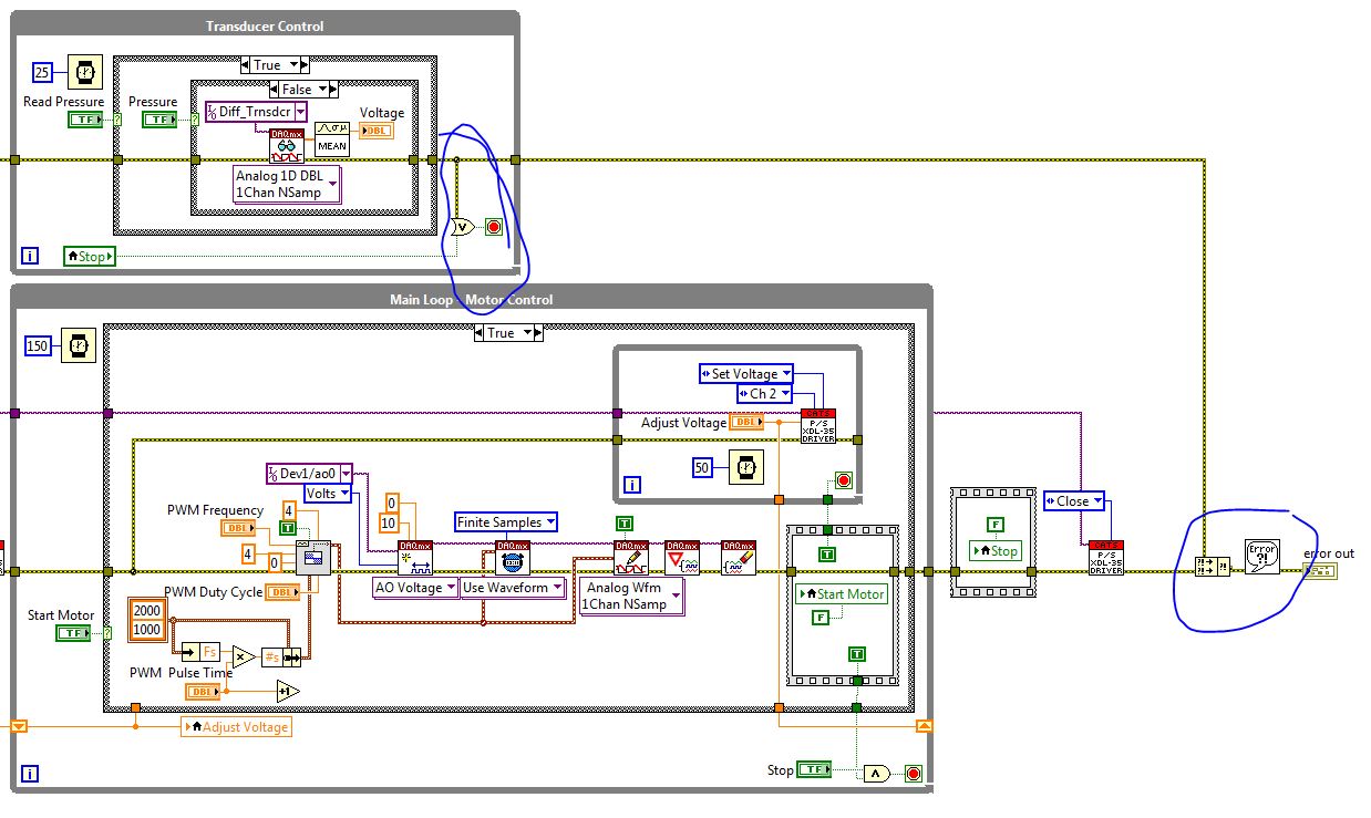

Actually, after I look at that code I suggested, you will probably need to add some logic to allow the top loop to terminate the bottom one if an error ocurrs.  Try this maybe:
http://www.medicollector.com

I can't seem to attach a VI.  So I show the image instead:

Attached

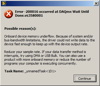

What type of error were you receiving ?   Added all the error control and this is what I got. Note though that this is generated from the task in the bottom loop.
I was getting this error previously but though I cleared it up when I removed a utility that kept the screen saver from activating. That had seemed to stop it.
So now it comes back when I try to run both the analog in and analog out tasks at the same time.
