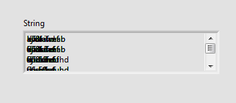

Normally, when select the scroll bar on any string indicator in labview and drag it up and down, the text moves accordingly.
However, when you use the mouse wheel to scroll and the string indicator is not selected (only the mouse cursor is over the indicator), the text just overlaps endlessly until one moves the mouse cursor over the scroll bar. See the attached image.

Thanks to you, I just found out that it is only when the STRING indicator's background is set to TRANSPARENT that it doesnt work. Thats mucho sad 😞

Wow - VERY reproducable.  🙂
Unfortunately I have no answer.  Sounds buggy to me.

It "blurs" for me, too. Unless the indicator has key focus, which highlights it.
Message 6 of 13
(5,698 Views)
Furthermore, customizing the control and putting in a background picture doesn't help.  And it seems that the control refreshes itself when the mouse moveseither onto or off of the control.

Sad to see that this is still a thing in 2018 😞
Of course the simple work around is to *not* use transparency.
