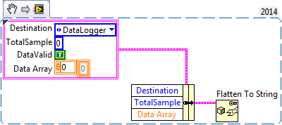

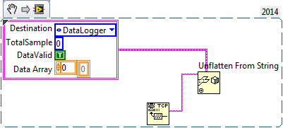

Hi Cristina
We like to use the Flatten To String, at the sender end, and Unflatten From String, at the receiver end, to package and un-package string data.  You can flatten (and unflatten) multiple different data types into one string.  We like to use clusters (type defined) as they are good from a readability and scalability standpoint. e.g.

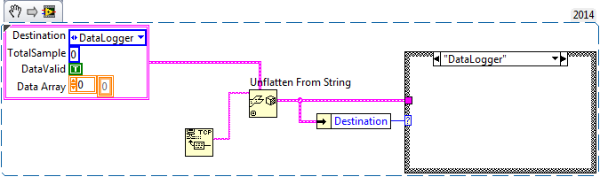

We usually include a Destination (or similar) parameter in our data that allows the sender to define where, in the receiving application, the message should go and also gives us a convenient way to switch when the data arrives. e.g.
Hope this helps
Steve
