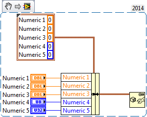

If you wanted to transfer the values of Numeric 1, Numeric 2, Numeric 3, Numeric 4 & Numeric 5 using the method discussed above you would do something like this

I do this, but when I want to read in server and I use Unflatten From String and unbundle I obtain an indicator not a control.
Maybe, I would have to do a new tcp communication changing the roles?
Use a Local Variable to update a control.  Note that is it usually really bad UI to have the code manipulating controls that the user should be using.

Hi Christina
It is probably best to think about it as data rather than a Control or Indicator.  I agree with crossrulz,  firstly question why you need to update controls in your Server.  Could you change your Server to better accept the data being received (is there a better way to do things)?   If not then use a local variable to update your controls.

My goal is following:
I have three .vi  one in FPGA , one in Host-target and one in Host-computer and I want handle all program from the computer, and in this .vi i want to change the control for they'll change in target (host and fpga), so that, I want see the controls and indicators in conputer (server)
