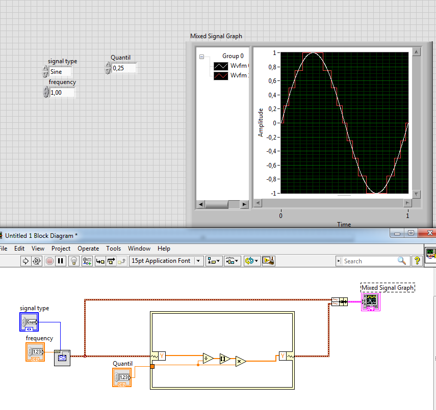

There are many ways to manipulate / filter / analyse data.   Mean filter, Median filter , all kind of stuff.... But the most wanted and simple 'Do what I think I need'-filter is hard to realize in a general way 😉
Please explain in more detail what you need to do.
You measure a signal, please provide a data sample, that helps us to provide ideas and test them. Just copy the graph with the data into a new vi,EDIT- MAKE CURENT VALUES DEFAULT, save and post that vi.
If YOU analyse the data, what steps are YOU doing (what rules do YOU apply) to get the result you need?
That information is needed to build an algorythm 🙂
For me it sound like you need median filter and a quantisation.... or maybe something with a hysteresis or a window like trigger ?
