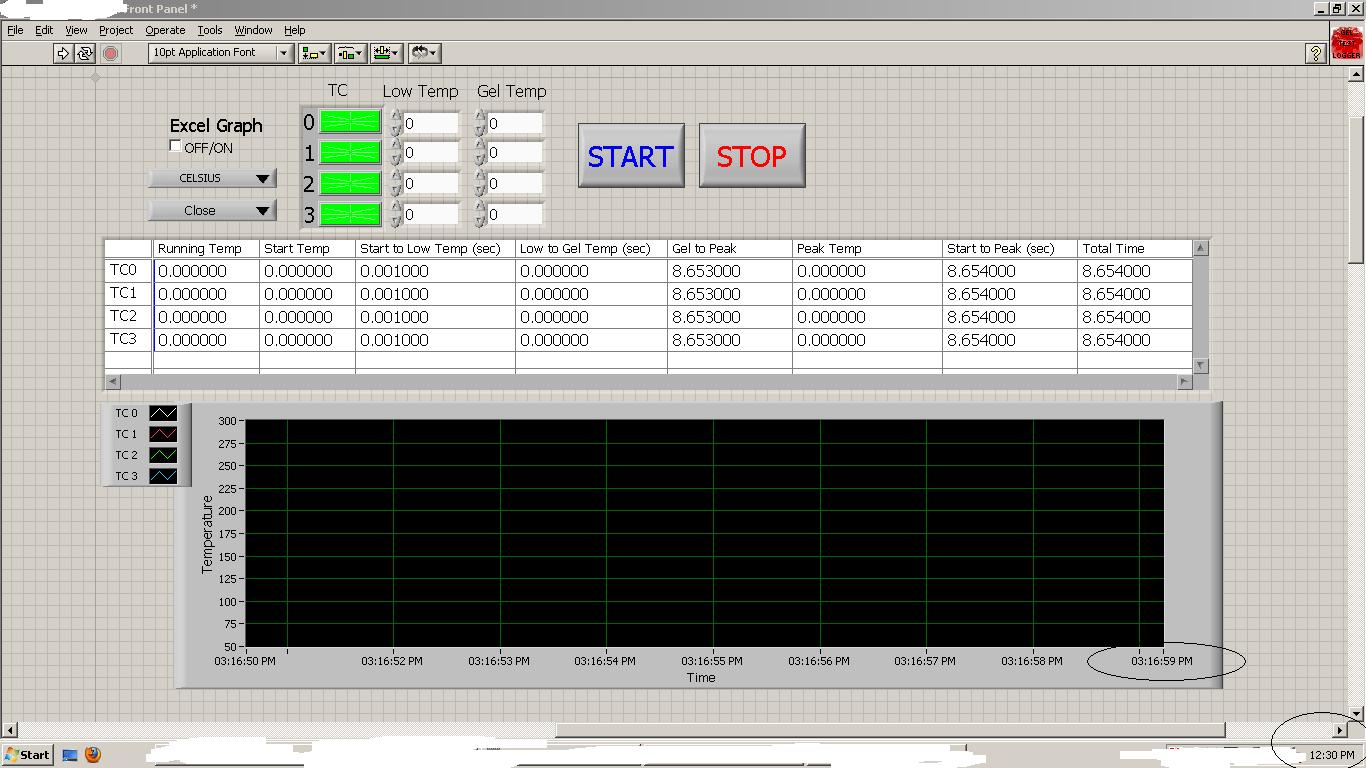

When I use a USB temperature collector (NI 9211A). I create a Graph. The x-axis being time is 4 hours fast. I do not know how to fix it.

Hi Dragon,
well, what do we see on this frontpanel?
- There are no plots visible, so the formatting might just show some standard values instead.
- In the table above the plot you only show times in seconds with a value of 8.65s.
- The plot xscale is set to show a range of 9s - wow, this might be connected with that 8.65s shown in the table.
- There is no indication how you set the xscale...
- And yes, there is a difference between computer time and time shown on xscale. But see point 4 Smiley Wink
How is the plot generated? How is it set to 3:16PM? Can you show your vi instead of the frontpanel? Can you show a stripped down version just showing the problem with some default values in the controls? A frontpanel is not enough - I can generate the same...

Sorry I am new to this. Does this Vi. help? One version is in 2009, the other in 8.6.

You are not writing any time information to the graph. A graph or chart does NOT automatically read the system time. It is something that you have to programatically provide. There are several ways to do it. Since this example is obviously not the same as the image you posted, we still have no idea what you are doing and really no idea how to fix it exactly. Why won't you post your real code? How many more posts are required to get some real information from you?
If you are acquiring DAQ data, then request a waveform data type. That dattype includes timing information. Otherwise, get the current time and use a property node to set the offset and multiplier. Look at the exampe programs. One is called Real Time Chart.
