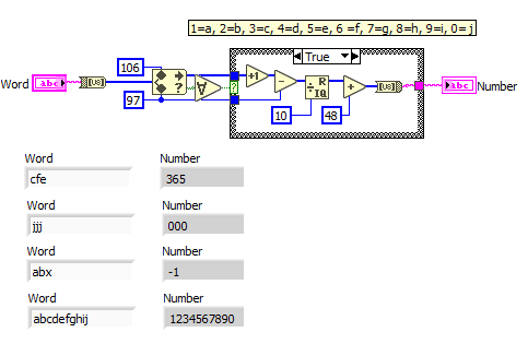

Assuming "0" is actually "j", here's a quick draft. See if you can figure it out.... 😄

It would be interesting to know what to optimize for (memory, CPU, clarity) and under what conditions.
Altenbach's routine will be hard to beat when the string is large and all characters are in range.
If the string is large and an early character is (or are statistically often) invalid , a for loop could be faster.
Not sure if you're looking for extra credit (or to learn more than asked), but there's plenty opportunity for that... Big O notation, statistics, parallel execution, etc.

We really don't have the full problem specifications. One issue might be that the output is a numeric string, not a numeric datatype. Any scalar numeric output will immediately limit the allowed input length, even for U64. My code works for any length that fits in memory.
And yes, for large problems, further optimizations are possible. (For example using a 8bit LUT with 256 elements and a conditional FOR loop that stops on the first failure. 😄 )

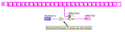

I think we may need to take a step back and provide some simpler help to get the OP started.  A good general way to convert inputs to outputs in a systematic way is a lookup table as Altenbach mentioned.  In this case since your inputs are numbers and outputs are letters, you can just index an array of the alphabet to get results.
This small piece of code can then be used in a larger program (SubVI Time!).  The next step might be to put this code in a case structure so it will only run when the inputs are valid (number between 1 and 26).  After that, run the whole thing in a loop which takes one number at a time and pass it into the conversion code and outputs an array of letters which you can then reassemble into a word.
