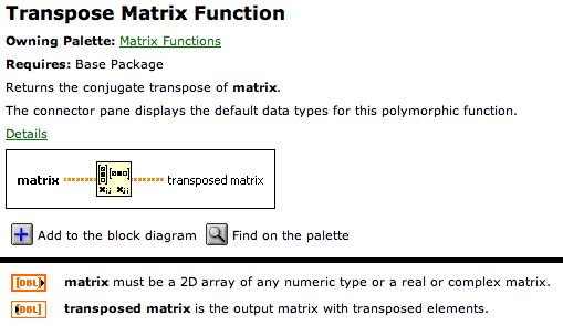

It is the Transpose Matrix function.
Lynn
Lynn
I thought of that (which is one of the reasons why I asked what LabVIEW version was being used). But...  What does your Transpose Matrix look like? Mine (8.2) looks like this:
And the LabVIEW 2009 Help shows the same icon.
I don't think I need glasses that badly. Smiley Very Happy

It is the Transpose Matrix FUNCTION, not VI.  It is in the Matrix subpalette of the Mathematics >> Linear Algebra palette.
Lynn
Well, that explains it. Don't have that in 8.2, which is why I asked for the LabVIEW version.
To MJ40: how did you end up in that palette? That's more of a curiosity question.
