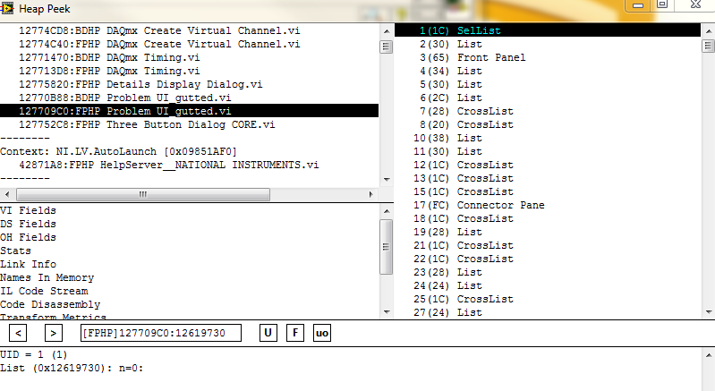

Very odd
from the BD ctrl+A ,ctrl+C, ctrl+N, ctrl+E and ctrl+V fixes everything.
NI should open that vi with a debugger.....Oh where is that heep peek ini entry thing again......
[Edit: Here]

Yup an insane FP object
