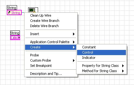

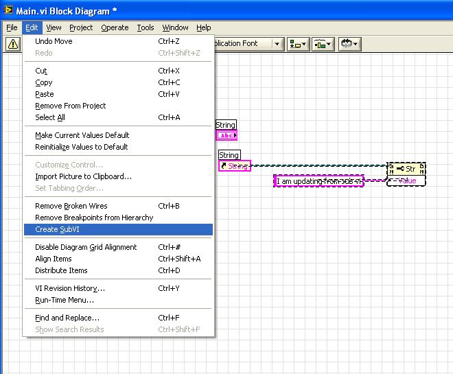

You can easily create this by right clicking on the output of your Reference of the string control in the Main VI and selecting Create Control,use the created control inside the SUB vi.

Thanks again this is easier than created a refnum ctl and then "select VI Server Class" 🙂
