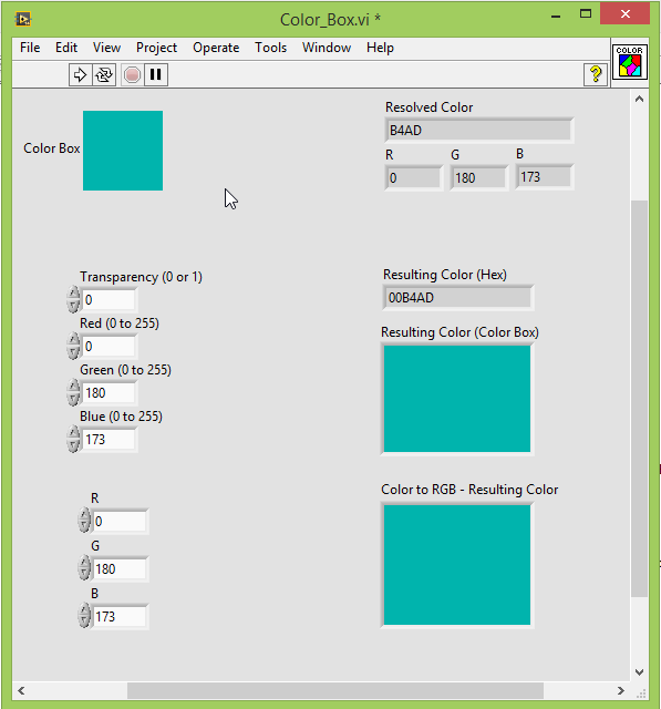

 Hi, what is the relation between the value that coming out from color box and the color selected in Front panel as in the attached image ?

   Thanks for the reply. The link you have given helps me to undertsand about colors used in labview. But still one point i need to understand further. In  the attached image irrelevant value( I think) is flowing from color box to the variant node. Thats what i am asking for. Relation of that  data to the color i have chosen.

The value you are getting is 46253 (decimal), just convert it to Hex format and you get 00B4AD which is six digit Hexadecimal representation of RGB Values.
-Like first two digits representing Hex value of R and next two digits to G and last two to Blue.

The value is relevant. Check the attached vi.
