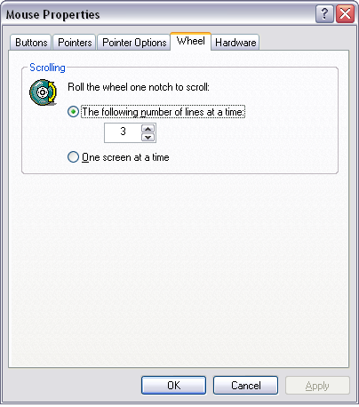

There are no previously reported issues similar to what you are seeing, it may be device specific. Could you observe the effects (if any) of changing these settings in Mouse Properties:
You may have something slightly different due to the mouse driver but there will be a similar setting somewhere.

Hi Mark, i narrowed the problem down by not including any software on startup in the msconfig setup.  Then i discovered the mouse to operate as normal so by method of elimination, i narrowed it down to a unwanted pointer installation which i deselected and then ran as normal.  All is well now.
