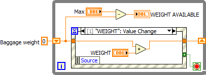

Maybe this can give you some ideas .... (other event case is for max/esc: value changed)
