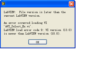

Sorry, still can't open your code. I understand you, maybe it is really codec issue, i am not sure. NI also integrate this code to DLL file, we can't find out how it work.
