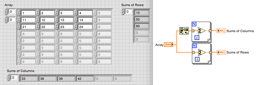

Arij,
You still have not indicated whether you are using an array or a matrix.
The Transpose should be outside the loop.
This will give you the sums of all rows and all columns.
These are basic LabVIEW constructs and functions. If you do not understand the concepts, please look at the on-line tutorials.
Lynn

I'm using a matrix, and I did place the transpose function outside the loop, and got pretty much the same block diagram you have there.
Thank you though
