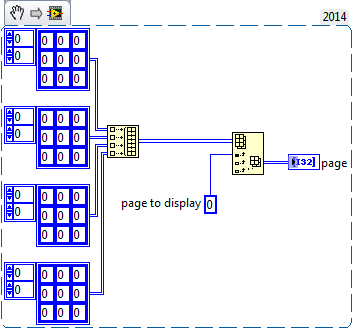

1. Use Build Array to combine all of your 2D arrays into a 3D array.
2. Use Array Index to get the page you want.
(4,567 Views)
An example of using the build array function:
