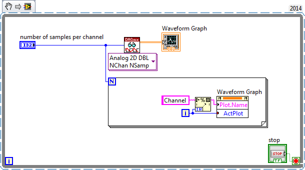

@Munna232 wrote:
Check this.
Without comments, it's not very clear what it is doing.  For example, why are you basing the amount of plots on the number of samples?
Plus, the ActPlot has to be the top one, followed by Plot.Name or it will be naming the LAST active plot.  They go in descending order, right now you are setting the plot name, then the active plot, when I think you want to do it the other way around.  You always want to specify the plot you want to work on first.
Bill

Hello Bill,
Thanks for your comments. I will write clear information in my next posts.
I’m sorry, Instead of No. of channels I connected N value to No. of Samples.
Munna

@Munna232 wrote:
Hello Bill,
LOL yeah I figured you just chose the wrong one.  🙂
Just remember about the property node.  They execute from top to bottom.  🙂
Bill
