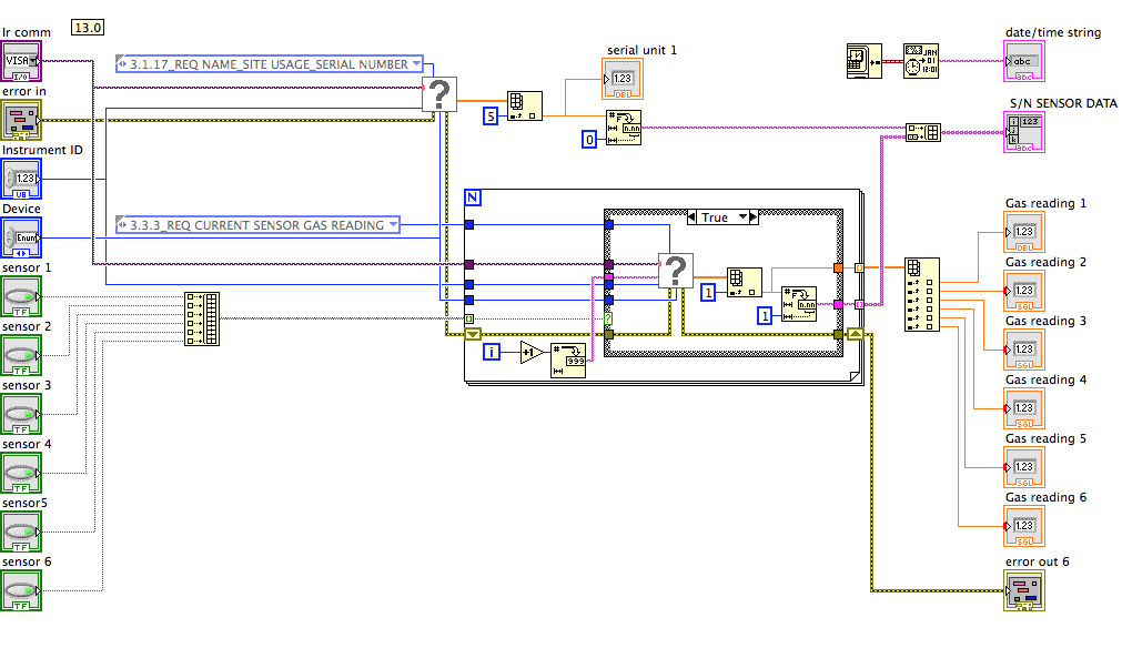

here is a copy of my code im having memory problems with i know it is messy this was one of the first things I did in labview about 2 months ago
Message 12 of 28
(2,380 Views)
  • What is happening in the subVI you have not attached?
  • Why don't you use a culster input in the subVI instread of all thse boolean connectors? Use an array of readings as output.
  • So you are running this every 10ms. Can you measure the actual loop rate? Maybe the subVIs get slower and slower due to memory issues? Is the subVI reentrant?
  • Can you show us the subVI code?
  • You really need to use lowlevel file IO as already explained.
  • What's up with all these coercion dots? Why are some wires SGL and some DBL?
  • Why is there so much duplicate code?
Message 13 of 28
(2,369 Views)
here is my subvi
a cluster would be better you are right
read time frome devices are aroun 2 seconds
sub vi is reentrant
Have to look into to coercion dots
dup code was trying to read from all 10 device as fast as i can
Message 14 of 28
(2,359 Views)
Actually, use an array for all of the booleans going into the subVI.  You can replace most of your code in the subVI with a FOR loop.  Why?  Notice that all of your case structures that are strung together are exactly the same, just slightly different inputs to look at.  Using an array of booleans, you can autoindex and run as many iterations as you need without any extra code.  I would also then change your numeric outputs to be an array as well (autoindex output tunnel on the FOR loop).
Duplicate code = subVI (make it reentrant if needed).

As crossrulz said, arrays will simplify your code considerably. Also you seem to have an aversion to straight wires (although that may be due in part to the stupid autowiring tool).
Lynn
Message 17 of 28
(2,331 Views)
Your subVI contains missing subVIs. Why is there a coercion at the visa resource going into them?
Message 18 of 28

Looks alot better and more simple than my layout but if i run this program i sent you after a hour i will use 250mb more ram and after 6-8 will get out of memory that why i was asking if you seen any where there could be a memory leak. Its driving me crazy
Message 20 of 28
(2,300 Views)
