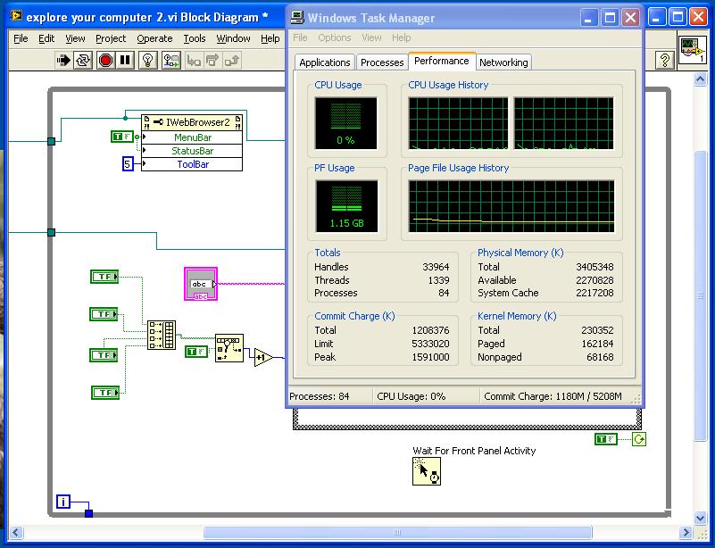

ok,
but this is what is happening when i use the function
I think you CPU usage shoots up because of some other reason not because of Wait For Front Panel Activity.Smiley Wink

Somil wrote:
here it is
  • Why are the upper two property nodes inside the loop? They never change. They should be before the loop.
  • Why are you branching the reference wire? I doubt the property nodes can execute in parallel.
  • The string control should be "limit to single line".
  • Why is the front panel maximized? That's annoying.
  • I probably would use an event structure.

Ya, i also observed nothing with the property nodes. But even if you put them before loop, still you cant observe anything.
Also, see the effect of not wiring the property nodes.(Attached image) even though the property nodes can run in parallel

What Altenbach was trying to tell you reg the property nodes is that if you branch the reference wire to 2 nodes, they may not execute in parallel. Also for things that are NOT going to be changed per loop iteration, it is meaningless to place them inside the loop & simply keep them running (writing/reading the same value across all iterations till the loop is stopped). Thats is why he told you to keep them before the loop. Smiley Happy
Not to disconnect the ref wire from one of the nodes; if you do so, LV will automatically show you the Syntax Error [broken Run button]. Smiley Wink
