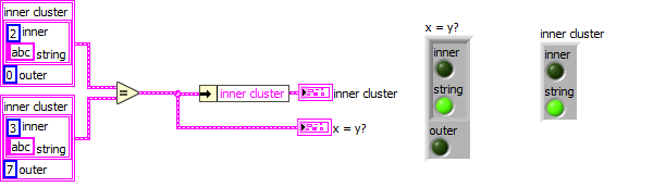

For example, I am getting the whole settings as one cluster, and I want to check each sub-cluster for changes compared to the old settings (which means which instrument I should update.)
Message 3 of 10
(6,065 Views)
Sounds like you need to right click on the Equals node and choose Comparison Mode > Compare Elements.
But the picture doesn't really show much at all...
Why would an image of a front panel explain the problem???

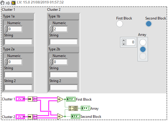

This what i am getting:
(code-1, front panel result-2)
and I want to compare only the clusters (so get only 4 Boolean elements)
Can you explain what that even means?
That is a day-dream.
Best you can do is check the aggregates and if not equal break out each sub-cluster and compare aggregates on each.

By unbundling each element and then comparing at the levels you care about, you can get what I think you're describing...
