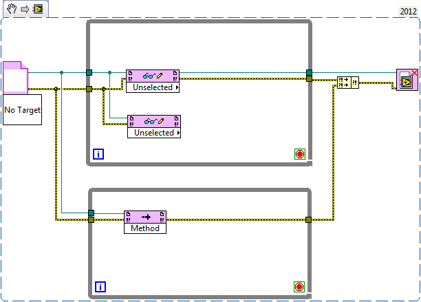

Hi Sara,
I had a quick look at your vi's.
As you say, the RT vi won't affect the FPGA resources, but general good practice is as Dan says, to try and just have 1 reference to the FPGA. You can split this wire and use it in multiple parts, and then just close it once everything is finished, like below:
Looking at the FPGA resources, eliminating coercion dots where you can will save some resources, as the FPGA has to buffer twice.
Try and use fixed point where you can too. Particularly I noticed in the top loop you take an I64 from the FIFO, then split it into 4, which leave 16 bits for each part, but then you convert to a I64 for each one, which is unnecessary, then use the local variable (which is ok to do) to pass the value into a function which requires a fixed point input. Always try and use the smallest data type, as it reduces the number of LUTs for each calculation. I think this will enable you to get the current code onto the FPGA.
I think the SCTL is probably not taking too much resource. I expect most of the resources may be used in the spliner loop, but you can try taking loops out and seeing where the majority of resources are being used, and then focus on reducing those parts.
