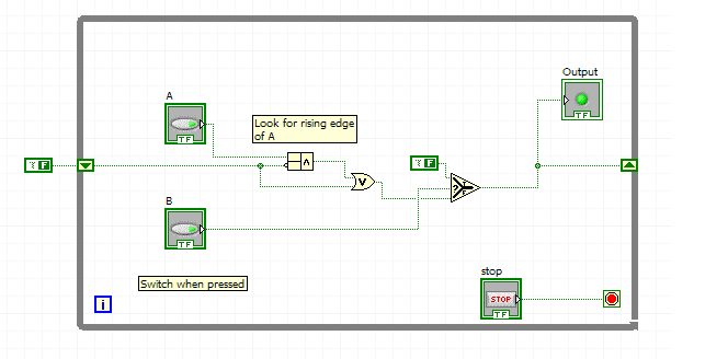

Try this.
The code is a bit more convoluted than i would like, but it seems to work.  In LV 8.5

(4,673 Views)
I can't save back that far.  But here is the screen shot.
