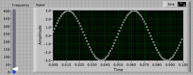

hello sir.
             discrete form means sampling.i need sampling of the output sine wave, in that attached vi.
(2,896 Views)
It is already sampled. Any data used in a digital computer is, by definition, discrete and sampled.
The default graph settings draw a line between the data pojints so it is not so obvious. Change the plot style to isolated points.
Lynn
