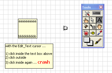

crash LV2013 ?
Can anyone confirm this behavior? (LV2013 for me)
same behavior with 2012 or/and 2011 ?
thank you all.

I tried it in LabVIEW 2011 and 2012, and it does not crash in those versions, but it reliably crashes in 2013.  I reported this to R&D in CAR 424308.

Hi ouadji,
We are already aware of this CAR (there is another CAR # for it 408955). The crash occurs when you are not using the autotool and you edit comments. For the moment the workaround is to use the auto tool for editing comments, we are investigating the crash. The crash only occurs in LabVIEW 2013.
Thank you for reporting it,
Jeff Peacock

CMal , Jeff-P ... Thank to both.
(This bug occurs in the file label.cpp : Label.cpp(752) : DAbort 0xBC0BF185)
This problem is already known (CAR 424308/408955).
ok.

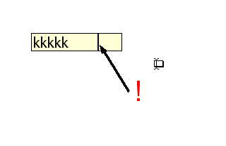

@MaxCrunch :
"However there is strange behaviour in that you have to click in the text box twice to be able to edit it."
+1 ... After the first click, the cursor is like "frozen" in the text box. (LV2013)
The cursor is no longer in the text box, but inside the box there remains a "frozen" cursor
