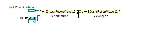

I'm using labVIEW 2011 to build a database management software,
I'm using SAP crystal reports 2008 version 12.3 to design my reports,
I'm trying to run these report from labVIEW GUI
I did these steps
1- inserted active x container
2- Selected active x object (Crystal ActiveX Report Viewer Control 12.0)
3- Created a property (Report Source)
4- Conncted the crystal report file
thank you in advance 🙂

You don't show where the error indicator is connected.

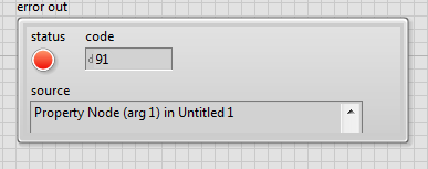

You don't really say what your problems is, but I guess you are getting the error shown in the picture and you don't like that. 😄

Hi sir,
thanks for your reply
the error indicator is connected after the view report method node
My problem is that the VI does not work as I expect
I expect that the crystal report file is opened and viewed in the active x container, but this doesn't happen 😞

Error 91:
LabVIEW:  The data type of the variant is not compatible with the data type wired to the type input.
Try converting the path to a string ( using the path to string function from the File I/O -> Advanced File Function palette) before wiring it to the Report Source input

The same error !!!

first you should open the application reference and then call OpenReport.
try if this works

This should work with LV_2014, I used it with CRXI RDC installed.
Once you visualize the report, you can also act over ist parameters, select zoom, print out, modify and save by using proper methods.
Let me know if it is working..
