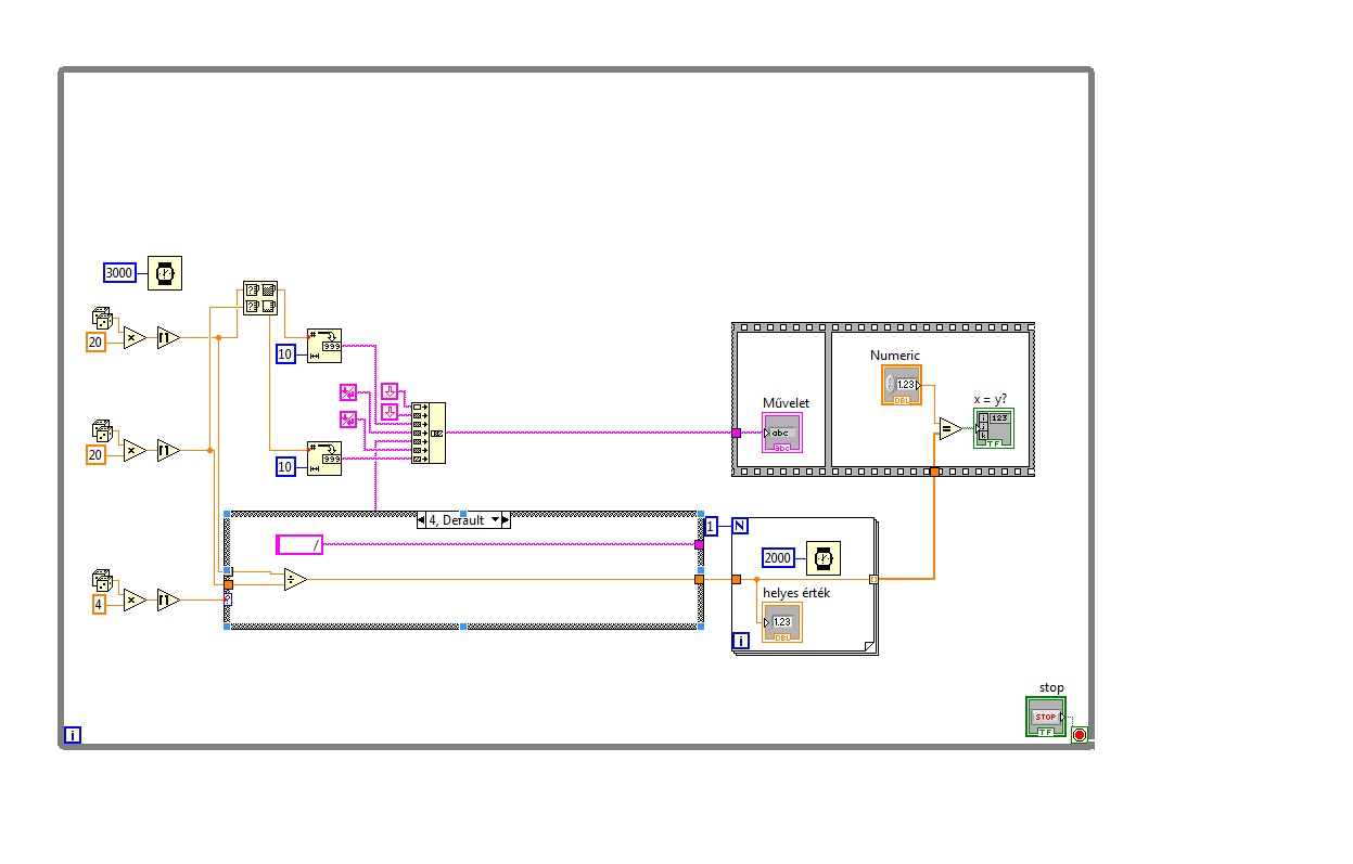

I want to make the lumosity raindrops.operations must be very simpleNévtelen.jpg

Next time please use a reasonable thread subject. "divide" does not mean anything useful. Thanks!
Please attach the actual VI instead of pictures. What is inside the other case? What is the purpose of the FOR loop? (You seem to sue the FOR loop as a glorified sequence frame). Where do the hidden wires actually go? What is the point of the linefeeds? What is the point of the two waits, they seem to run in parallel? What is the point of the sequence structure? Seems pointless. Do you really need a formatted width of 10 characters for a two-digit number?
Can you explain what you mean by lumosity raindrops and how it relates to your question?
Also make sure to answer my questions form the other thread.
