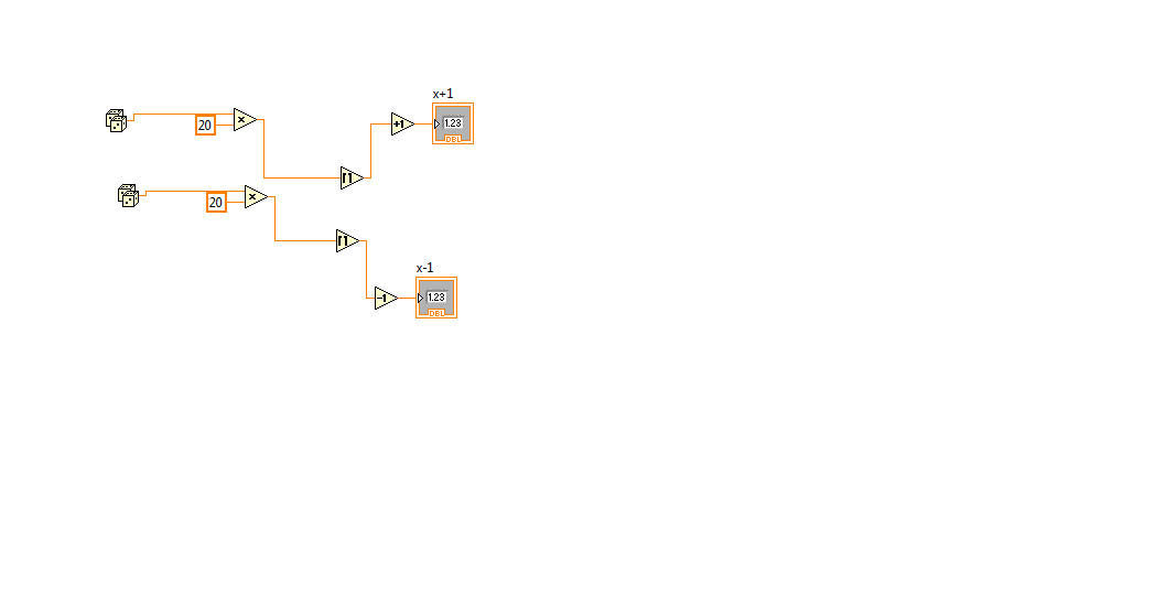

szabolcs,
That will not work per the requirements.  You can still get random numbers so that the top number is 1 and the bottom is 19 (playing the worst case.
Here is the solution I am recommending.
Message 12 of 19
(3,184 Views)
already made it.THX
Message 13 of 19
(3,167 Views)
That will not guarantee that one number is greater than the other.  Although unlikely, it is possible that both values could be the same.
Lynn
Message 14 of 19
(3,146 Views)
i expressed myself wrong .It's enough that the value isnt negative
Message 15 of 19
(3,126 Views)
how can i generate such numbers where the two number's remainder is 0?always
Message 16 of 19
(3,104 Views)
I would generate two random numbers and then multiply them.  Take either of the original numbers and the multiplication result.
