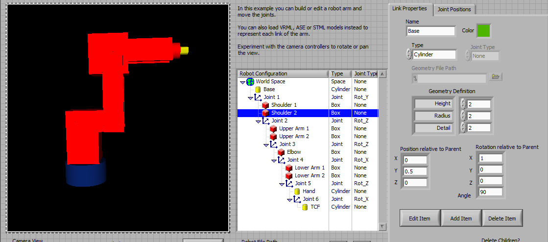

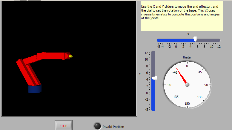

i try to make an animation for Lynxmotion robot arm
i have open two example that provided by labview robotic module and i get two example that graph two type of arm
can any help how to change any of these two example to make animation for Lynxmotion

The easiest thing that you can do is upload the CAD file of the robotic arm that you need in the LabVIEW program. It is quite probable that if you do an internet search you will find the CAD files for the arm you are using.
Also you can take a look at this link that talks about importing CAD files:
https://decibel.ni.com/content/docs/DOC-17358
