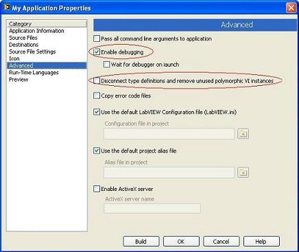

Hi Iskander,
What version of LabVIEW are you using?  This is a known issue that was fixed in 8.2.  The issue has been shown to happen when building a VI that includes a subVI containing a shared variable.
If you are using a version of LabVIEW earlier than 8.2, the best solution is to upgrade.
If upgrading isn't an option for you, here are some potential work arounds:
1.  Check the Enable debugging option in the Advanced category of the application executable properties
2.  Disable the Remove Panel option for all SubVIs containing Shared Variables in the build
3.  Uncheck the Disconnect type definitions and remove unused polymorphic VI instances option, also in the Advanced category of the executable properties as shown below
4.  Move shared variables to the top level VIs and pass the data through the SubVI connector
I hope this helps!
