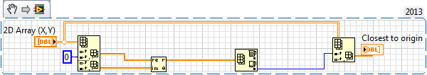

Fairly straightforward
Use X[] and Y[] as Real and Imaginary Rho is distance to origin.   find the minimum

Hi beam,
calculate the distance between your points and origin (0, 0). Find the minimum of all distances…
See this simple math on your array data:
