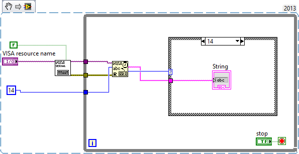

I use VISA serial in my program in LV2013 for read data from MCU. each time MCU send 14 byte for LabVIEW and in LabVIEW I use this VI to read data. if data read count was 14 byte, my VI in the case will be executed. here is snippet from my code. (I simplify the VI and in case other functions will be executed and it worked well).
I run this code and it use pooling method and CPU worked always for it. it may be cause to VI run slowly.

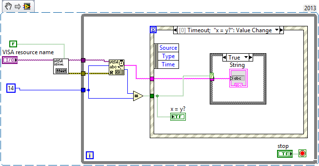

then I meet EVENT structure in LabVIEW. it seem to be good and professional. so I use EVENT structure in my VI. but when I use below VI it doesn't work !!
in your opnion why this cannot work and what is your suggestion ?
I use and indicator that named " x= y? " for add compare function to event structure.

I use VISA read functions for communicate MCU with LV2013. each time I send 14 byte that contain a begin char (like 'T'), a termination char (like 'R') and 12 byte data between them. MCU send 14 byte with high baud rate like 460800bps or higher.(I use PL2303TA USB to Serial). time distance between each send is approximately 100us. I put my function and other stuff in a case loop. read function is in while loop which you can see a snip from VI below :
everything is OK.
but recently I met EVENT structure in LV and have been interest to it. I want to use EVENT structure for reduce CPU load. but when I put EVENT structure in my VI, it odesn't work. the picture o my VI is below :
I use an indicator for create an event on "equal " function output in EVENT structure.

You are not using the event structure correctly. The event will not fire for an indicator like your code expects. You would have to write to a value signaling property outside the event structure but it just seems you are complicating the code for no good reason. There is no real problem with your original code though the case statement seems pointless. There should be little cpu load.

first of all, thank you Dennis for reply.
how I can write to a value signaling property outside the event structure ?

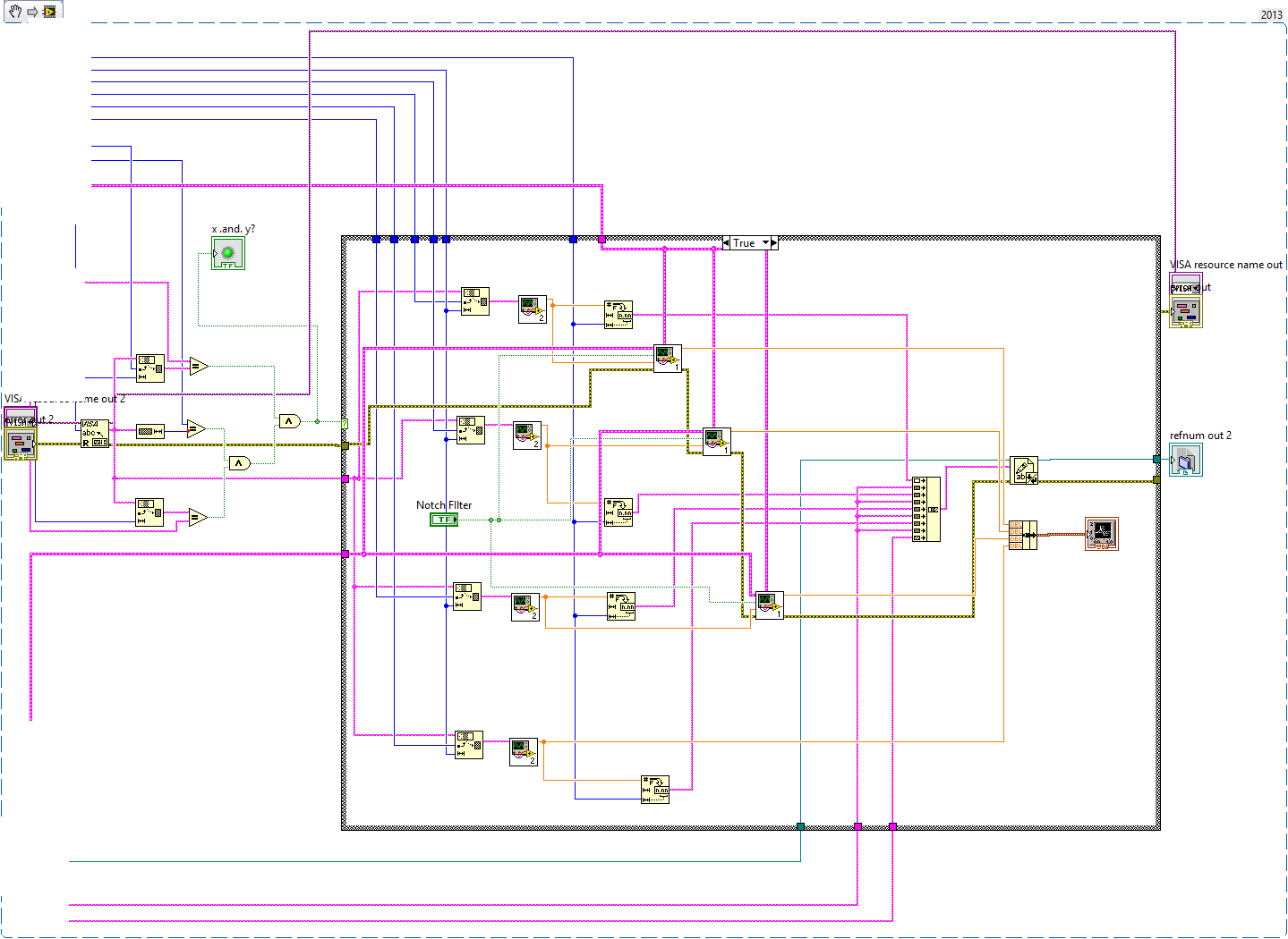

in my final program in case statement I use more functions like filtering data, write data, calculate data, and showing on chart for 4 seerate data whici extract from incomig data from seial port. for this reason I sayed CPU load is high.
3.pngI want to use EVENT structure to save CPU time and power.

Since you would be reading the serial port constantly anyway, there would be no difference in cpu loading. What benchmarks have you done that show a high load?
In any case, just create a separate loop or place the read in your timeout event.

By putting your reading of the serial port into a seperate loop, it can run completely independant of the rest of your code.  Your read loop does nothing but read the data on the serial port.  You can then use User Events or Queues to send the read data to whoever needs it.  This is how I set up all of my streaming serial applications.

I use a form of the Producer/Consumer.
