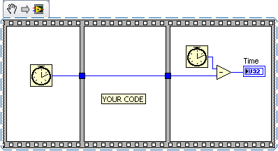

hi,
if you want to determine the time of the vi, you need to use the tick count vi

As Pattos and Somil suggested, use the Tick Count node.
Adnan Zafar
Certified LabVIEW Architect
Coleman Technologies
(5,846 Views)
It is a small "but" to the suggestion from Adnan Z. If the code you want to test execute fast. You must put it in a for loop a execute it say 1000 or 10000 timesThis because the timer tick resolution is 1 msec at the best. Windows is not a real time system, so you may also have some jitter in the Tick Count output
