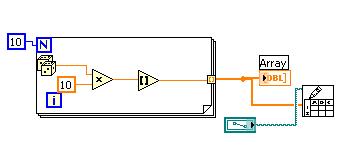

This will create the excel file with the random numbers
17973iEB28EECC9AB8CD2A

Thank you! I got it now
