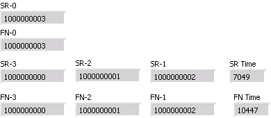

@P Anand wrote:
This is what I get when I run your code still you stick on to your point?. ( LV2011 version)
Can you post your benchmark VI?
Also please give the system parameters (RAM, OS, CPU and so on).
I see no actual reason for such a huge difference between the performance since, as written before, there should not be any performance difference if both mechanism are used in a comparable way.
So either you have a flaw in how you benchmark the timing or you are using both in a different way!
Norbert
EDIT: And again, as Altenbach pointed out correctly, you DID DISABLE debugging for you benchmark, no?
Norbert
Expert: Geometry
Message 32 of 40
(1,537 Views)

@Norbert_B wrote:
@P Anand wrote:
Norbert
That is not my benchmark vi and crossrulz has given the link. When I run the code in my machine (2011) I got SR outperformed FN ( I am not sure debugging enabled or not). I support neither SR nor FN just trying to know what drives FN more than SR in performance.
Message 35 of 40
(1,515 Views)
