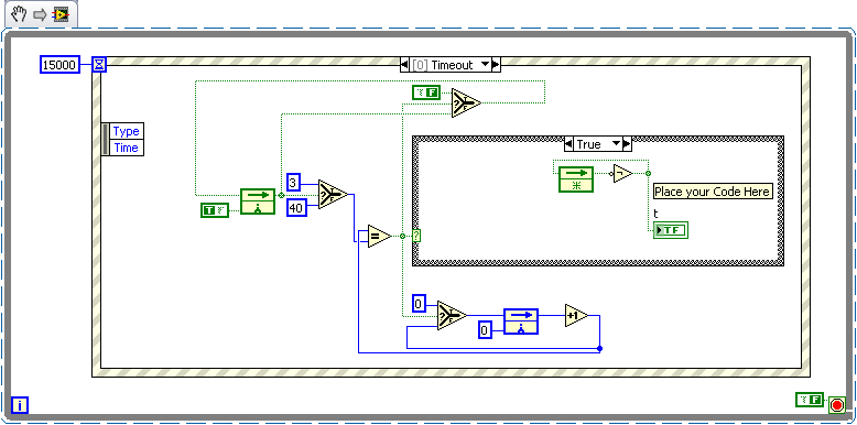

You really don't want to use a FOR loop for all that. The program needs to be interruptable at all times.
I suggest an event structure in a while loop. As an example, see also my links posted in my comment to a related idea.
