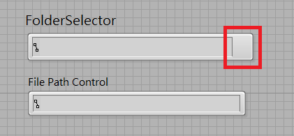

  I started my own xcontrol by putting a single path control in the UI. In the event of direction change, I set the the property of the indicator of the path object based on the "direction". But I found that it doesn't really change the control (path object) to indicator (since the file browser button still there).
Any one has any idea how to make it work?

As shown in above image. The top one is my xcontrol, in which I wrap a path control and I set the it indicator by changing the color and make the browser button invibible. But you will see there is still space left (red region).
The bottom one is the standard path control. After we change that to indicator, the browser button and space gone.

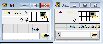

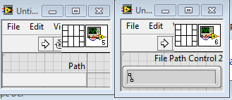

If I use LabVIEW 2012, place a silver path control, then hide the browse button (right-click...visible items), the frame border is even. I have not tried programmatic changes.
I tried the same way and see the same thing too. But just don't know why it behave differently when I do that with program.
